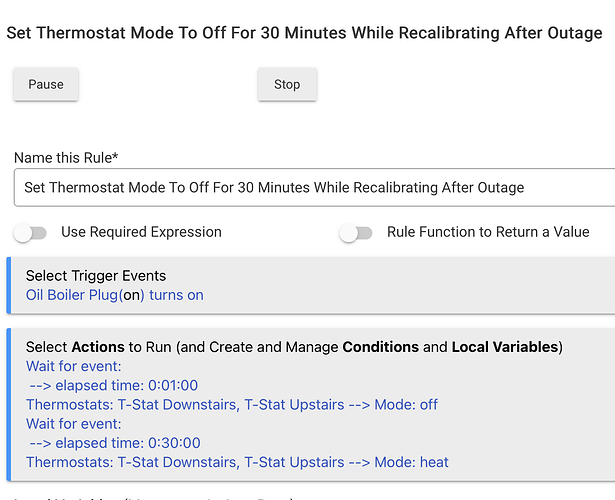

Hey, I just thought of an actual use for the HomeKit Controller Integration and my Ecobee thermostats!
After transfer switch goes to utility power, turn off Ecobee heat mode for an hour. Then turn it on, maybe depending on the date. I love it. I think.
Seems to work in testing, lol:

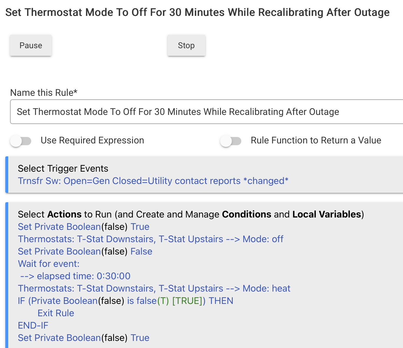

The trigger I was using wasn't good enough for every scenario. Also, the logic below worked during testing...no true/false stuff. We'll see next time the real event happens...hopefully not in a while.
The thermostat takes about 50 seconds to boot up, so I allowed a minute.
I also disconnected the router to modem cable, and it worked perfectly. As @gopher.ny has said, and I'm paraphrasing, "local is good". :slight_smile:
