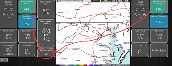

In my experience, good luck with that. They kept trying to blame my humidity issues (10 and 15% off compared to calibrated - in an ISO 17025 accredited calibration lab - devices) on the air flow in the wall behind the stat. Only, that wasn't an issue because I created 3D Printed backplates that Isolated the back of the stat from the wall. When I let them know that, they then suggested I buy newer versions.
My initial contact with them had just been to allow offsets greater than 5%, since there were known issues such that they had to put FAQ's up on how to cover the hole in the wall behind the thermostat (even though it is not a widespread issue on other brands/models when I looked it up). In any case, I now just ignore the humidity on the ecobee and use averages from other devices placed throughout the house. I would only recommend ecobee moving forward as a way to have local wifi control. However, if I ever have to replace, I will be finding something else. Nothing like being gaslit by a company that you gave money to and funny to see the responses when they do not know they are talking to someone who has worked for almost 40 years in the metrology field.

Light green is what ecobee says for humidity. Arrows pointing to the actual overall average humidity
