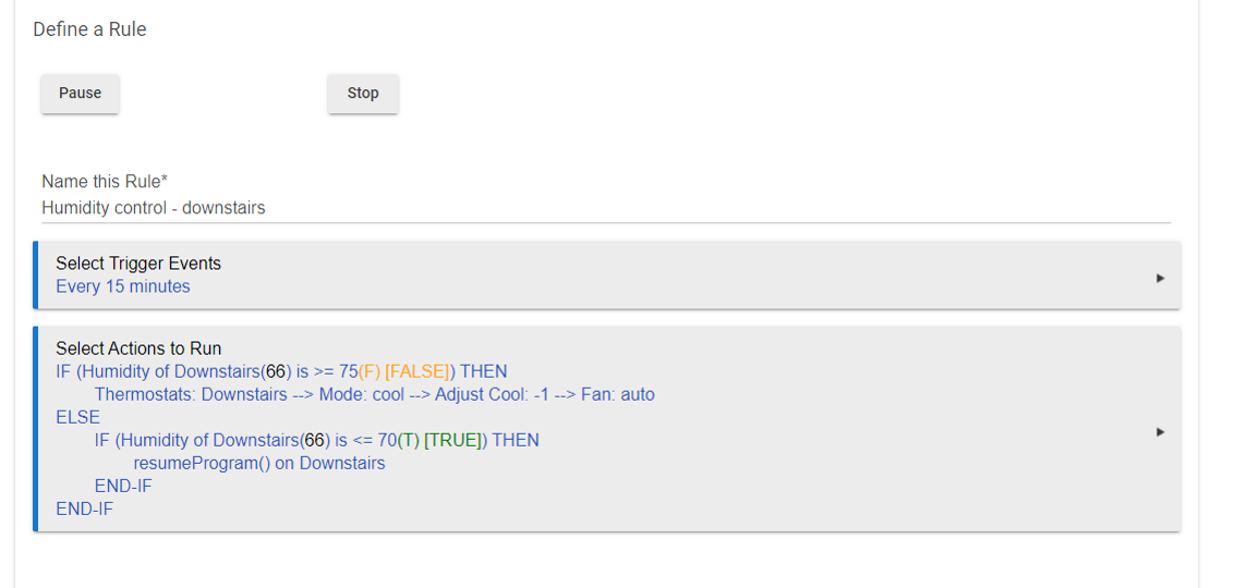

Until I get a dedicated dehumidifier for my house, I thought I'll start off with using the AC unit to keep the humidity in check, to some extent. So, I set up a rule in RM to force the AC to cool even if the temperature isn't high (but the humidity is) by lowering the cooling setpoint. Then, once the humidity is at a relatively lower level, I'd like the setpoint to go back to what's set per the program.
The rule works most of the time. But, at times I get an error as in the screenshot from logs. Any idea what could be causing this and how can I fix it?

I can't really find anything in your rule that should throw that error, unless it is caused by the ecobee cloud not being available temporarily.
However, I have a couple comments:
  1. It seems like your house gets really humid (a RH of 75% at any temperature can't be good for you).
  2. Your rule is likely to promote compressor short-cycling, which isn't good for your AC compressor. I would suggest decreasing the temperature by more than 1 degree (say 2-3 degrees), and decrease the frequency of your trigger to every 20-30 minutes.

  1. Yes, I agree. I live in Houston and it does get rather humid here. I moved into this new house barely 2 months ago and it is still under warranty. The AC company is supposed to come and take a look to check for any leaks, other issues, etc. Any level above 50ish isn't good.
  2. Agreed. What I have also set on Ecobee is what they call "AC overcool max" that causes the AC to cool an additional 1.5F to decrease the humidity. So, that's a total of about 2.5-3F. I just wanted to get started with the rule and change the parameters for fine-tuning as needed. I'll keep your feedback in mind though.
