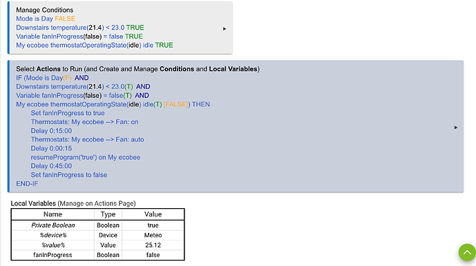

I created a Rule to switch on the fan for 15mn when temperature is over 25 degres outside.
But everytime the rule runs, it changes the requested temperature to the current one.
I tried to add resumeProgram() after switching back the fan to auto but it doesn't change the fact that it holds a new temperature.
is there a function to go back to the default ecobee settings ?

Yes that's my current setting. But as my next activity is at 10PM it means that just by switching on the fan for 15mn it will hold a new temperature setting for the day.
I was in the hope to have a way to reset back to normal

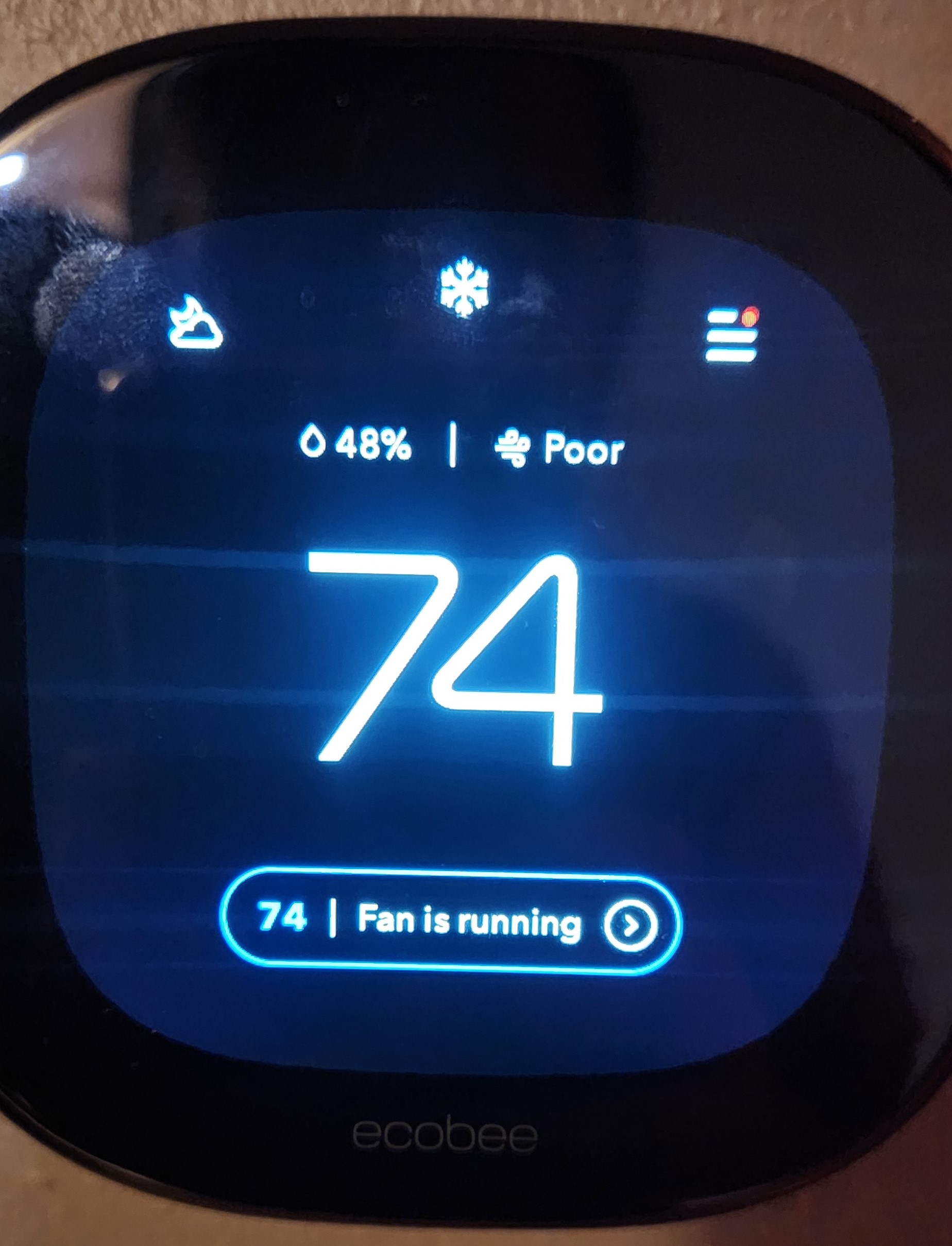

I took some photos to show the issue.
If you set the fan to run from the thermostat, here's what it shows:

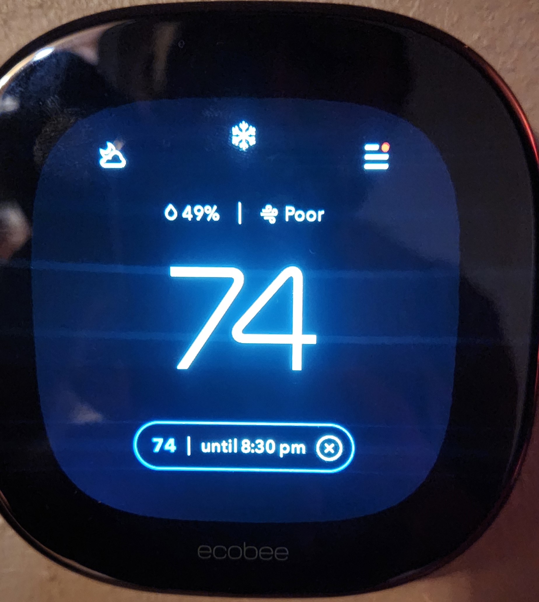

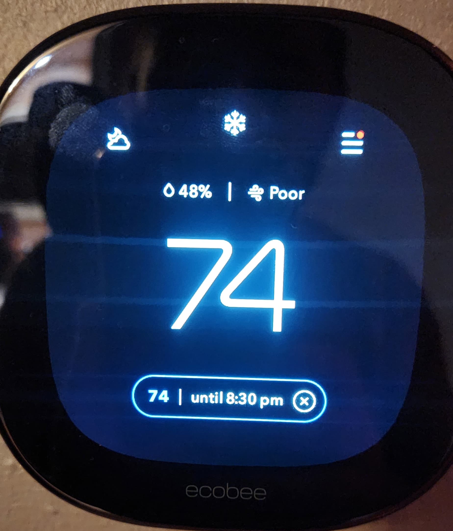

If you set the fan to run from Hubitat, it behaves differently (but the fan does run)

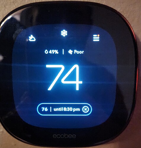

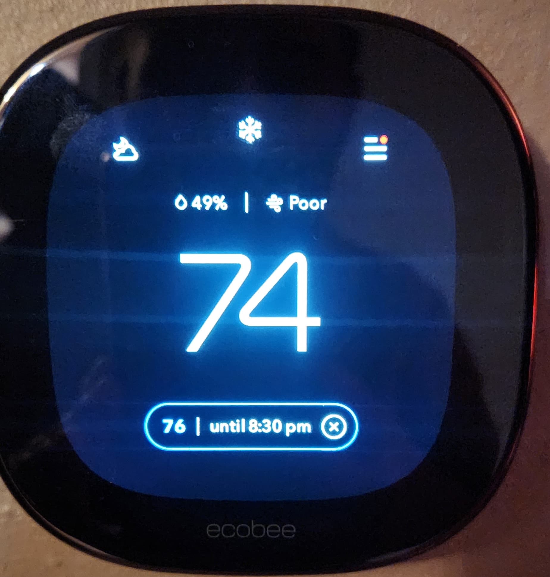

But if a temperature is requested on the stat:
and Hubitat sets the fan to 'on', it appears to clear the temperature request

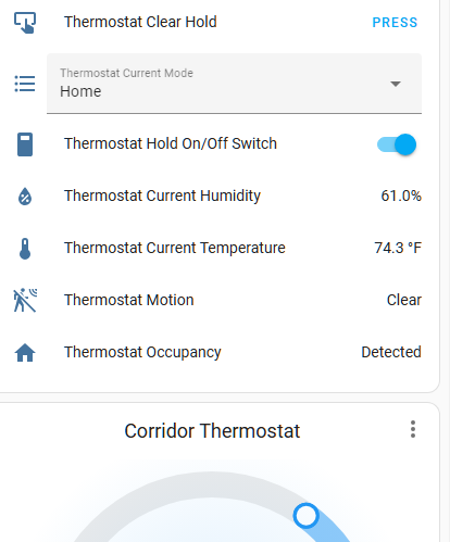

My Ecobee integration with HE is done via Home Assistant (BTW, 100% local, plus HADB. For some reason (and who knows why) Ecobee goes into Hold mode immediately after anything is/was charged either manually right from the touch screen or by command(s). It looks like this is known behavior because Home Assistant has a "Thermostat Clear Hold" button:
My work around is a very simple rule running on HA which is pressing that magic button when Thermostat reports any changes. There is an extra switch to Enable/Disable this rule in case I want Hold to be active.

On the stat itself, if you set a temperature and then manually turn on the fan, the fan runs and the requested temperature remains.
On HE, if you set a temperature and then manually turn on the fan, the fan runs but it changes the requested temperature to the detected 'current' temperature.
