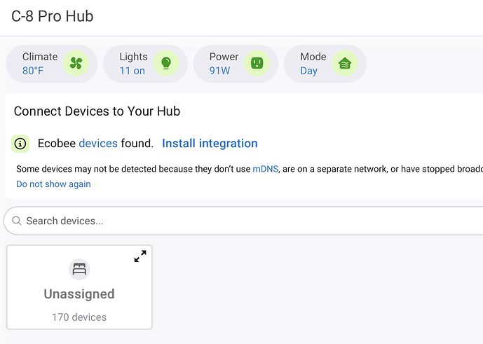

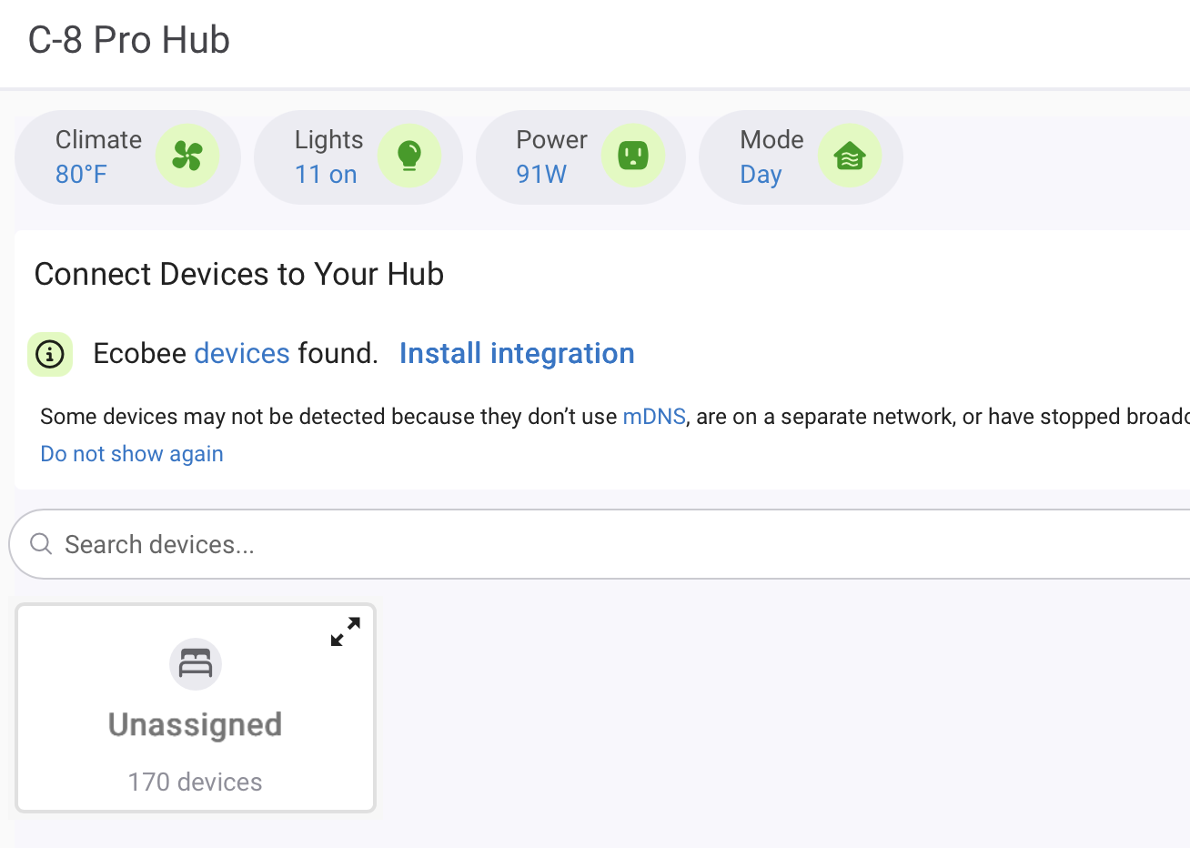

Just completed adding my ecobee thermostats via homekit integration, but noted that they don't show up in the home page climate tile?
Am I doing something wrong or is this a known limitation?

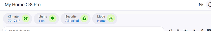

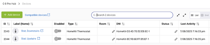

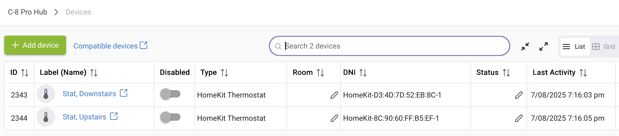

This is what I see.
Two thermostats are definitely installed via the integration.

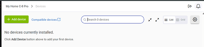

This is what I get when I hit "climate":
I don't use Home, so no big deal for me.
Fix is coming in the next build.
Confirmed fixed for me!
