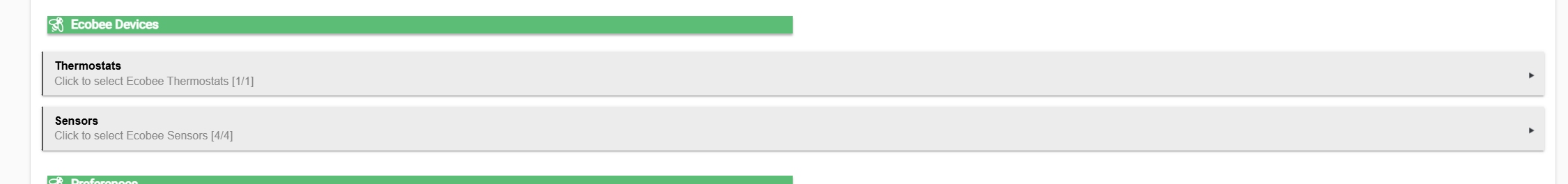

You do not need both. When you setup Ecobee suite you should have to go through a process of authenticating to the Ecobee Cloud. When you do that it should create your thermostat and additional sensors if you have any. One thing you may want to do is there is a option to enable the core thermostat as a sensor as well since Ecobee reports a average and a actual thermostat temp. That would be a additional step.
Seting up those items would be in the location shown below in Ecobee Suite. Not much there, but that is how you setup your sensor devices in Hubitat after getting the integration online.
Thank you! I knew I was missing a step ("Add User App"). All good now. Appreciate the quick response.
