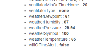

I am using the Ecobee Suite by Sandood, he esposes most of the internal variables weatherTemperature is the outside temp:
Of course, the Ecobee's value for outside temperature isn't being measured outside of your house. It is from weather data for your local area. Therefore, there's nothing really to be gained from getting your outside temperature from the thermostat over using a weather API as suggested.

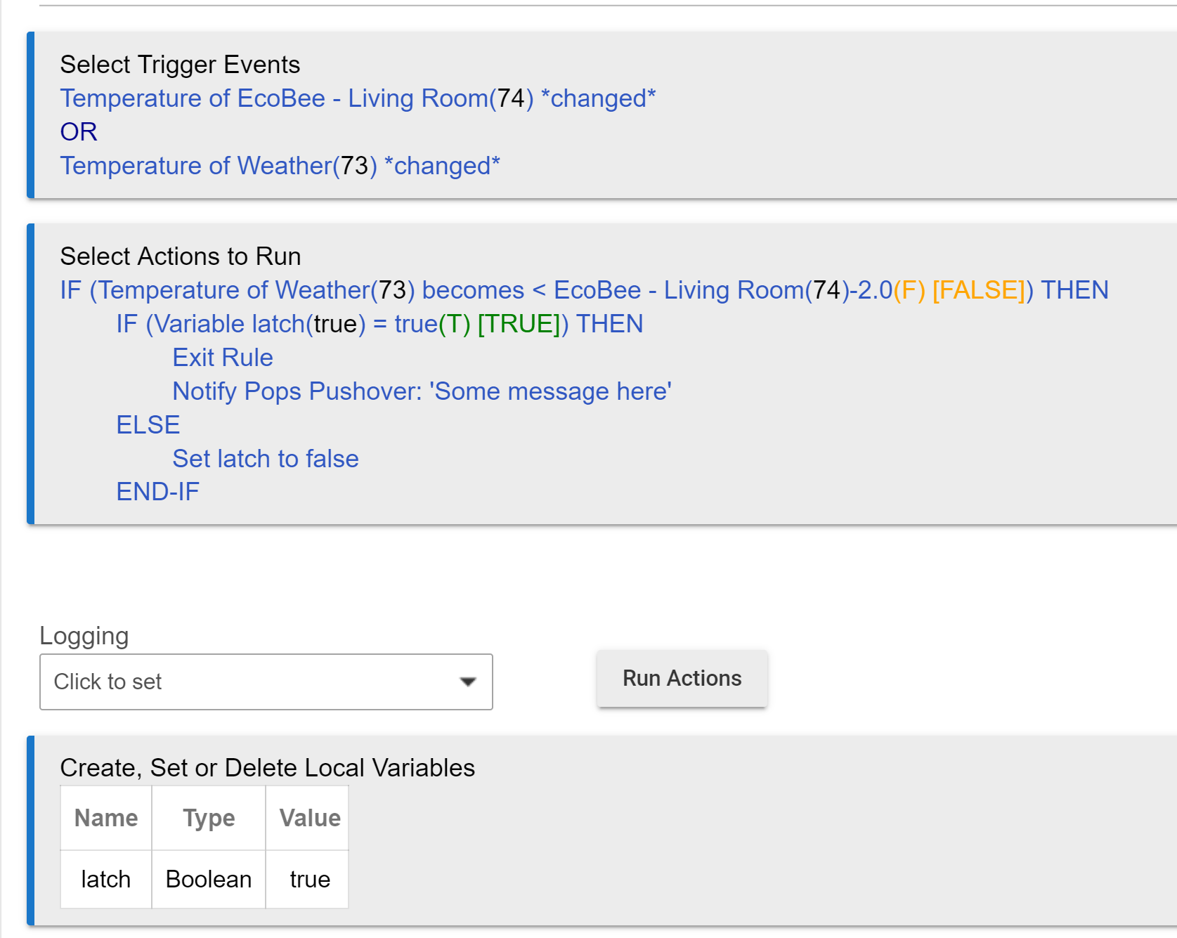

Looking for a Rule to properly use it against inside temp.
A basic rule I created last night based on temp on a trigger of the API > Ecobee house temp -2 kept triggering each time the API temp changed which is not what I want.
Ideally, I am looking to get a notification when the outside temp drops below inside temp
Thanks in advance
Rick

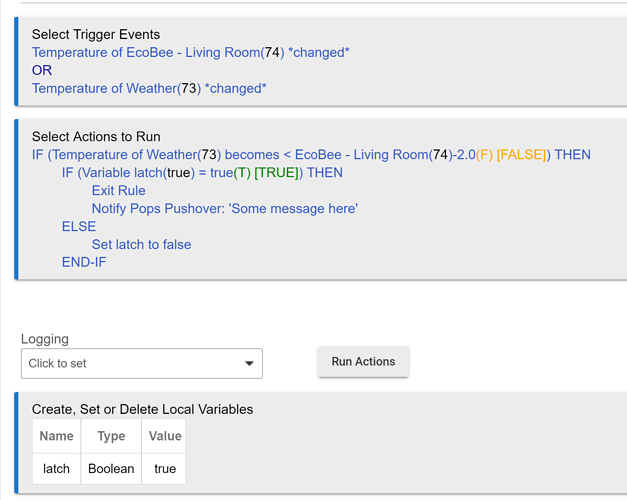

Looks about right to me, is this what you had in mind?
Rick
Put a end if after exit rule.
That way you exit if latch is true, you need to set latch to true after the notify as well so you are only notified once
TY :slight_smile:
