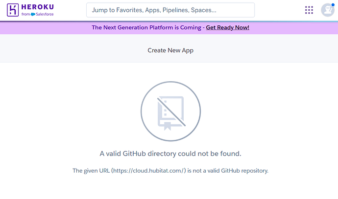

finally, i just decided to restart and rebuild a new app. now i am stuck. i am trying to deploy a new server but i get this message in heroku:
any advice? can you still setup echo speaks + heroku from scratch?
or does anyone know how to deploy a new echo speaks app within heroku from scratch without going thru the hubitat interface/integration, and then connecting it back to hubitat?
i am a paid heroku user. the error states "cloud.hubitat.com" it not a valid git repository - valid github could not be found. this is not a free/paid issue. i am not interested in running docker, but thanks.
Did you read that entire post?
i did. changing the URL is not available until after server deployment has started - i can't even get the server deployment started yet, so i cannot edit anything.
i am on step 2 of this " Now tap on the Deploy to Heroku button."
the page that comes up is above error page stating invalid git repository.

I think I figured this out. When you get the purple "Deploy to Heroku" button right click on it and copy the link. Paste that into a text editor (notepad or whatever). In front of heroku.com add www. so it is https://www.heroku.com/<leave everything else alone>
Then copy and paste that link into a new browser window to deploy.
Then follow my guide to edit the vars and get it working.
If this works I can edit the code on my fork to fix the deploy url.
thanks guys, but i drank the microsoft kool-aid a long time ago, lmao. i run win server 2019 at home 24/7, so i might look at the win option later.
making progress! adding www did make the deploy button work. however...

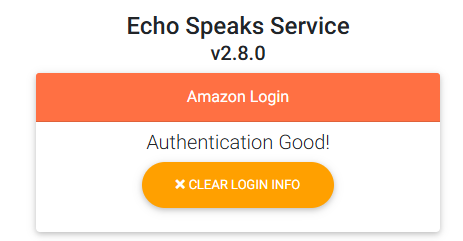

but when i am redirected back to the login page, it just says login like before. it does not say "authentication good!" like step 8 of the setup documentation. i checked my echo speaks app, and it says at the top:
"Login Issue:
You are no longer logged in to Amazon. Please complete the Authentication Process on the Server Login Page!"
i tried several times to go thru the login process, i tried using incognito mode, but i could not get to "authentication good!"

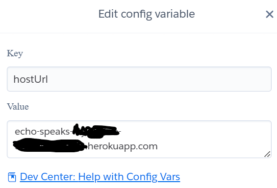

Did you edit the hostUrl on the Heroku server?
In Heroku try clicking More .. Restart Dyno
I know restarting the server usually fixes that login issue, maybe it will work on Heroku also.
yes, i did edit the hostURL:
and then i More > Restart all dynos
I would restart it again. It happens with the stand alone server too where it gets stuck like that and wont log in. Then if you restart the server it works fine the next try.

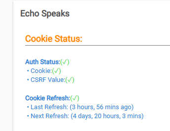

Did you use my forked code and set the host url manually in the app on HE also?
This is my test setup I ran earlier today, so I know it can work
