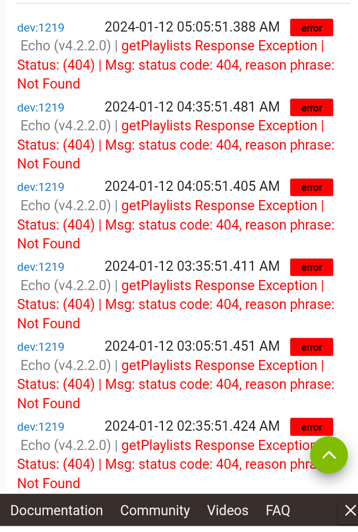

I see this error on logs. Also noticed that this on echo doesn't seem to speak the Echo speaks notifications. Not sure how to correct the problem. When I do the test speech and announcement on the ES app it works.
Old error with a kludgey way to resolve it. See this: [RELEASE] Echo Speaks V4 - #1483 by jtp10181
Where do I find the code? Looked in echo speaks app code the lines are not there.
per the post: "If you comment out line 999 in the Echo Device code"
