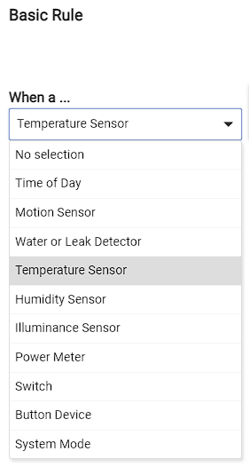

got it; I can see attributes being available as triggers in the Rule Machine. So, do I just ignore capabilities and do everything with attributes? What is the best practice here?
That depends. Capabilities are, essentially, actions that you can take on the device. Many of them also have predefined attributes (just keeps you from needing to explicitly define them in the driver). You could delete your line with attribute "pH", "number" and the pH attribute would still implicitly be there because of the "pHMeasurement" capability.
So, you could write a rule to use the "Refresh" capability of the device to force a refresh (assuming the driver has that capability mapped to a method). But, if you are just using the monitoring values to do some actions, then you just use the attributes.
