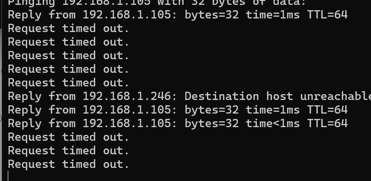

During setup lost access to C8 - blue light ~20 seconds
blue light is ON for 20 sec, then 5 sec no light, then 20sec blue and etc.
no access to previously known IPs aka diagnostics 8081.
anything else i can do?
(jsut bought it yesterday. connected to ethernet. then added my wifi network. device recommended disabling ethernet connection at this point. I did that, it was saying it its on my wifi with IP from wifi range. i siconnected ethernet cable and instantly lost access to network interfaces. restarted device and get blue light. i have UDM SE router and home iot wifi networks with 2.4 only. )
example of ping -t while i see blue lights..
like it cant boot itself
