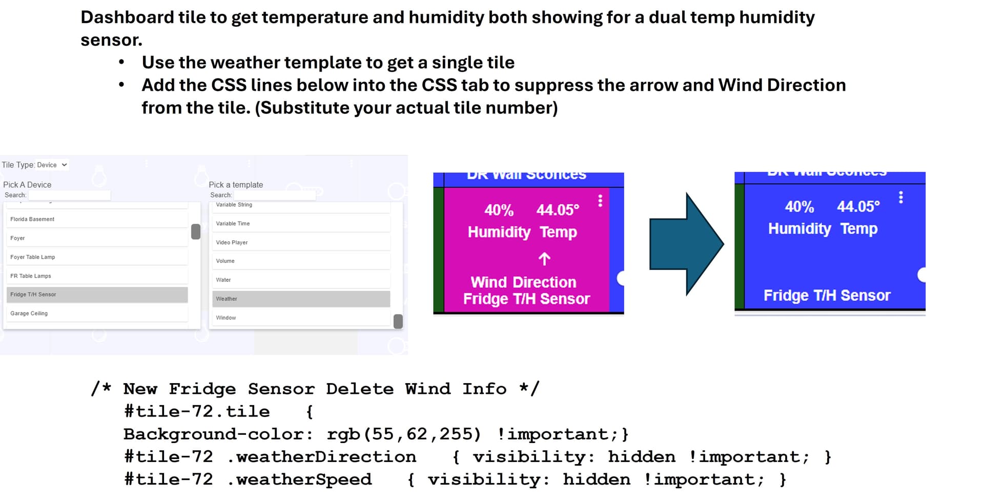

I recently added a zigbee temp and humidity sensor (Third Reality Model 3RTHS0224Z) to monitor my refrigerator temperature. I wanted to display this on one of my dashboards but couldn't find a native template for this. I also didn't want to burn two tiles for this, one temp, the other humidity. So I used the Weather template and modified it as shown. Maybe helpful to others down the road.
You can go even further to center-up the content inside the tile and increase the font size to make it more readable. You would need to play with the numbers for your tile size.
#tile-72 .weatherTemperature {
font-size: 14px !important;
position: absolute;
top: 35px;
left: 10px;
#tile-72 .weatherHumidity {
position: absolute;
top: 35px;
left: 50px;
I have this working fine for two different T/H sensor, one ZWave, one Zigbee.
The one wrinkle is the ZWave sensor puts our temp as 72.2 (one decimal place) and the zigbee as 72.23 or two decimal places.
Is there a simple CSS fix where I could suppress the second decimal digit on the Zigbee tile? I looked around but it sounded like I'd have to mess with the driver which seems outside my comfort zone.

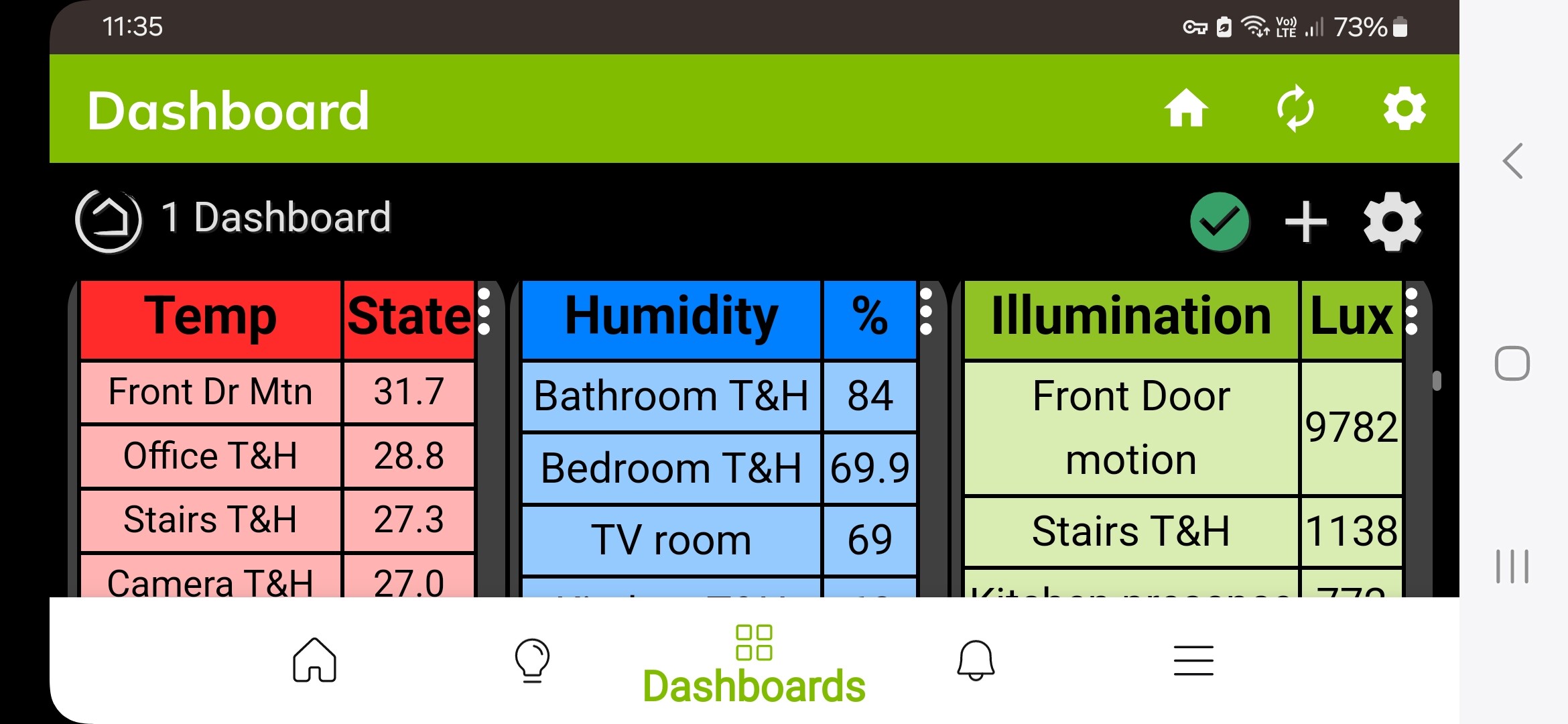

There's a great app in HPM - Tile Builder that let's you put heaps of info in a tile or two. I use it and love it. You can have mixed attributes on tiles too.
