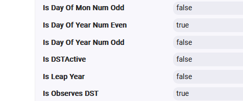

You could use my variable - and just wait for it to change state: (Found in Date/Time Parse
I think I'll go for oglewon's approach.
