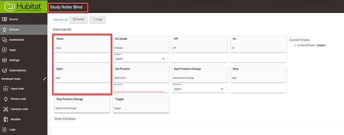

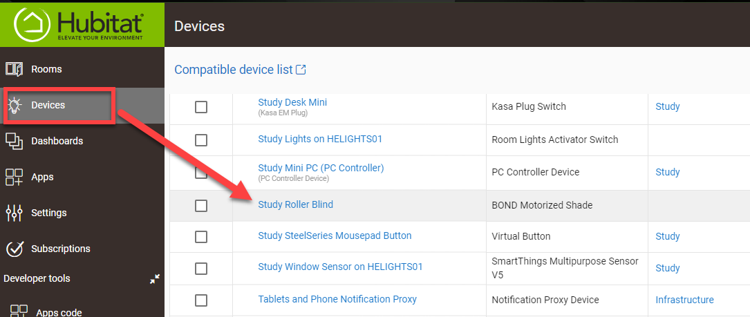

  • Re testing the basic device communication... thinking about it now, that is likely not your issue at the moment. But for future reference, if you open the HE web UI, go to Devices, click your device, the Device Detail page for that device will come up. From there you can run various commands, like you are effectively doing on the dashboard. E.g. If I looked at my Study Roller Blind, I can open it from the Devices list and use the same Open and Close commands that would be triggered from a tile on a dashboard, depending on the tile template I chose. The reason I was suggesting this, apart from being a common starting point for troubleshooting issues like this, is that it confirms that the HE hub can communicate and operate the device at a basic level, trying to isolate where the problem may be. If the device can't be operated from this page, the dashboard is not the issue.
