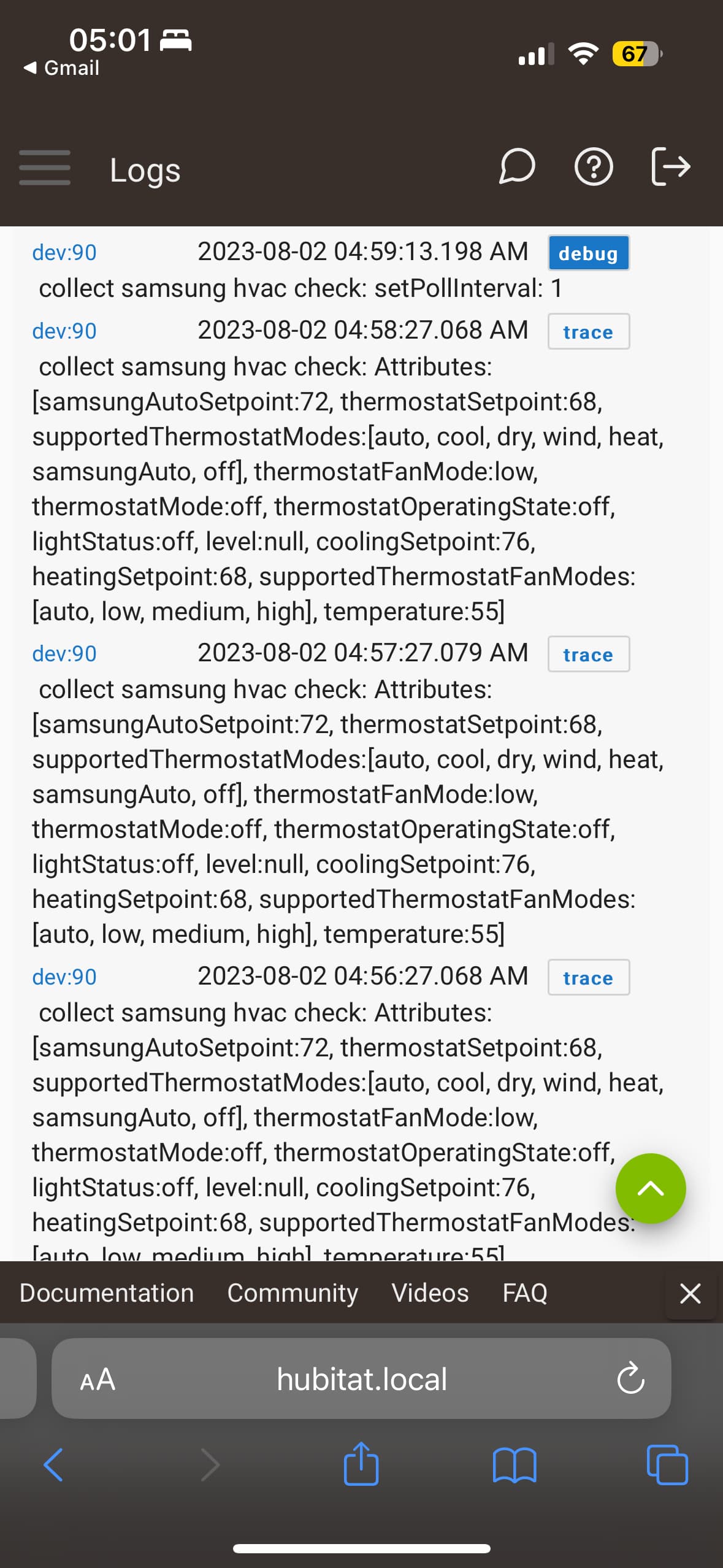

@djgutheinz Hi! So I have installed the HVAC driver. However since the smartthings/token link did not work I just took the auth token from the hubithings replica driver which I previously connected and still have. However even though I saw all the Samsung devices in the log and used the correct device id for the settings, nothing just seems to be working. Also see the log below. It seems fine. I wonder why does the AC not reacting at all?
turn on log-debug then do a save preferences. Send me the log. It has been a LONG time since I wrote this and I do not have the device (I did this for and in-coordination with another user).
See the screenshots. I did it from a phone hope thats ok?
Tested with Samsung TV using same SmartThings interface. It is working OK.
Two potential errors.
Invalid device id. Would throw : Den TV-4.1-1: distResp: [status:ERROR, httpCode:403, errorMsg:Forbidden]
Invalid API Key: Would throw: Den TV-4.1-1: distResp: [status:ERROR, httpCode:401, errorMsg:Unauthorized]
