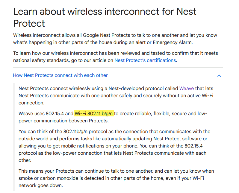

The Hardwired nest protects connect to each other wirelessly. They don't use the interconnect wire. I keep an ecolink on the one in the kitchen and when one goes off they all go off. So the ecolink picks it up.
When you do a test do they all go off? If so, and they use the interconnect wire then this should also set off the ZEN55 as an alarm. If they are only using the wireless interconnect then the ZEN55 would not be set off. I would trigger the test from the unit the ZEN55 is directly connect to as well.

Nests are wired and have no wireless interconnect. The use WiFi to have a network but I could never get any to connect to my WiFi. I took it down and put in a talking First Alert Smoke and CO unit. It works. The other one like it is in the bedrooms hallway, as recommended. The first is in a room with the fireplace.
They use your WiFi to talk to each other.

In case you’re still confused how nest protects actually work, it’s a wireless interconnect.
Nope. Only have one in the kitchen. As soon as one goes off, they all go off so the kitchen one pics it up.. I never had a problem getting them onto wifi, even on combined SSID's... Though I think they communicate through bluetooth for the interconnects/ I'm not sure what frequency they actually use. It's just a guess because I had all the wifi in the house down one day and kids were cooking and set them off. Was annoying because I had to go to at least 2 of them to shut everything down (obviously I couldn't use the app at the time)

Nest Protects were about the first to use a Thread network (but it was/is proprietary). The WiFi connection is not used for any smoke/CO2 communication between units.
Nest products use Weave. There is OpenWeave https://openweave.io/ . OpenWeave can use OpenThread https://openthread.io/
They are just another Zigbee device and listen to the sound, CO and Smoke have different universal tones. The instructions say to place within 6 inches. You probably have wired interconnect so they all go off. I was going to place mine next to the CO / Smoke one in the hallway but since this does not require battery changes I installed it instead.
Nest doesn't use wired interconnect, they use their own protocol. But yeah, if you don't have any sort of interconnect on your alarms, you would need one for each detector.
