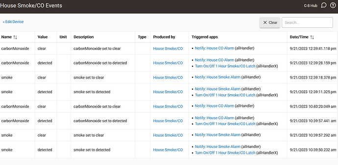

Just installed one of these. Will we get any type of alert when the test button is pressed?
If the device is able to detect it, you should. The driver is setup to handle it per zwave specs. I have not actually connected mine to an alarm yet, still on my test bench.
No change is status when I hit the button. I guess I will bring some canned smoke from work and test it.
Worked for me when I hit test button:
I see that now in events. Thanks!! It triggered smoke on mine.
