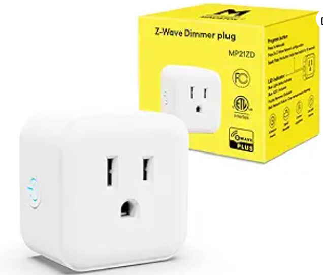

Jeff...will this driver work with the Minoston MP21ZD (no power reporting)?
In case this driver won't work, I'm using the "Generic Z-Wave Plus Outlet" driver with my three MP21Z (that's the 800LR non-pwr reporting version of yours there - it looks exactly the same), and it works fine -- been totally reliable for me.
There are only a few parameter options for these non-PR versions, so I just used Basic ZW Tool to set the couple non-default params I needed.
For some reason, I don't think it ever occurred to me to try this driver :person_shrugging:
Thanks. I'm using the EvaLogik driver now (same OEM) and that's worked fine, but for some reason I thought I should look at other options. Why? Because when things work you look for ways to break them!! :wink: :man_shrugging:
I tried the built-in Minoston driver and things went wacky...plug and lights it's in an automation with started turning back on again after I turned them off. It was late at night so I flipped back to the EvaLogik driver rather than troubleshooting. I had noticed this driver before but figured it would be interesting to see how things behaved with it if it is compatible.
Ha, yes, I forgot to add that I did try the Minoston driver - that was no bueno indeed :laughing:
Ah, so not just me. Thanks.
