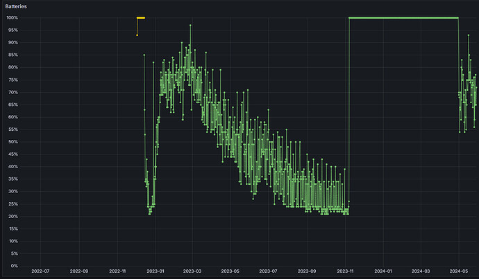

Looks like I have been getting about 1yr+ from the battery on my basement door, which is about 4ft from the hub so should have a very good signal and not be working very hard. This is an original ZSE41. Door is opened about 5+ times a day (yes I have a chart for that also). I also possibly snuck some partially dead batteries in there at some point to use up the last bit in them.
Looks like after this last replacement if the trend stays similar I should be looking at 1.5 yrs.
GraphMaster!
Excellent...at the distance I'm using it, I'd be pleased w/6-9 months. I've got a 3rd-party Z-Wave antenna on the C8-Pro which maybe will by me a few more kilowatt moments of the hub talking w/the sensor. :slight_smile:
