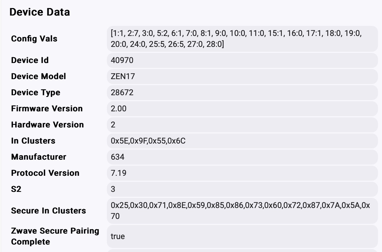

I have my Zooz17 controlling my front gate. Open/Close with R1 and Close Sensor on S1. I have added a "door bell" at the gate (momentary button) how do I access S2 with the 17 being set up as a garage door? I can hear it clicking when I hit the button but can't figure out how to add another Child Sensor. Thanks!
How about checking preferences? It's weird you don't have the children. A job for @jtp10181
For the newer relays Any time you change the input settings to a sensor setting you need to exclude and include the device again. I think this applies to input setting 4 and up? What are your input settings?
S1 - 7
S2 - 0 Previously 2
Original set up did 3 child devices R1&2 and S1. Not sure why it didn't set up S2.

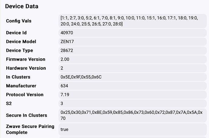

Maybe this helps?
So you have the 800LR model.
Easy way might be to set the input type to 0 as you have. You should get a status update on on the main R2 child where it will change to ON then back OFF when you let go of the button. You could also try input types 2 or 3 as well to see which works best. You may need to change the input trigger 2 (11) to YES (1). If nothing is connected to R2 this is harmless other than the clicking noise of the relay closing. This you can change and should work without excluding the device.
If you really want a sensor child you have to use input types 4+. You will want to set S2 input to option 10. That will create the child and it may work with just a power cycle of the ZEN17. If that does not work you would have to exclude and include again to get i to work correctly.

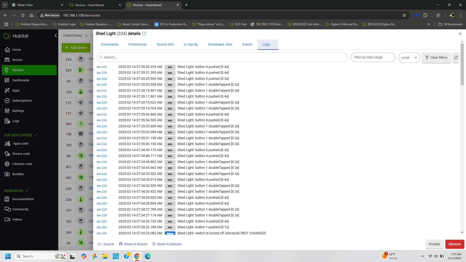

@bill.d curious if you're still experiencing this. I continue to have it happen. It's infrequent, but it does keep happening. Have you (or others) continued to experience this and any luck finding a solution?
And wondering if the Zooz folks know about the issue?

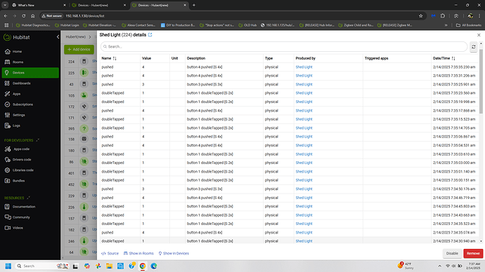

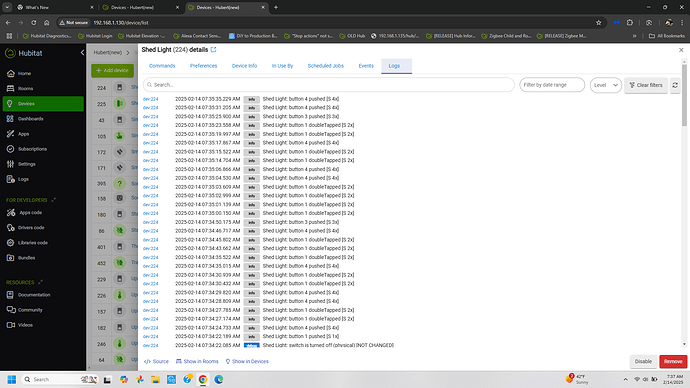

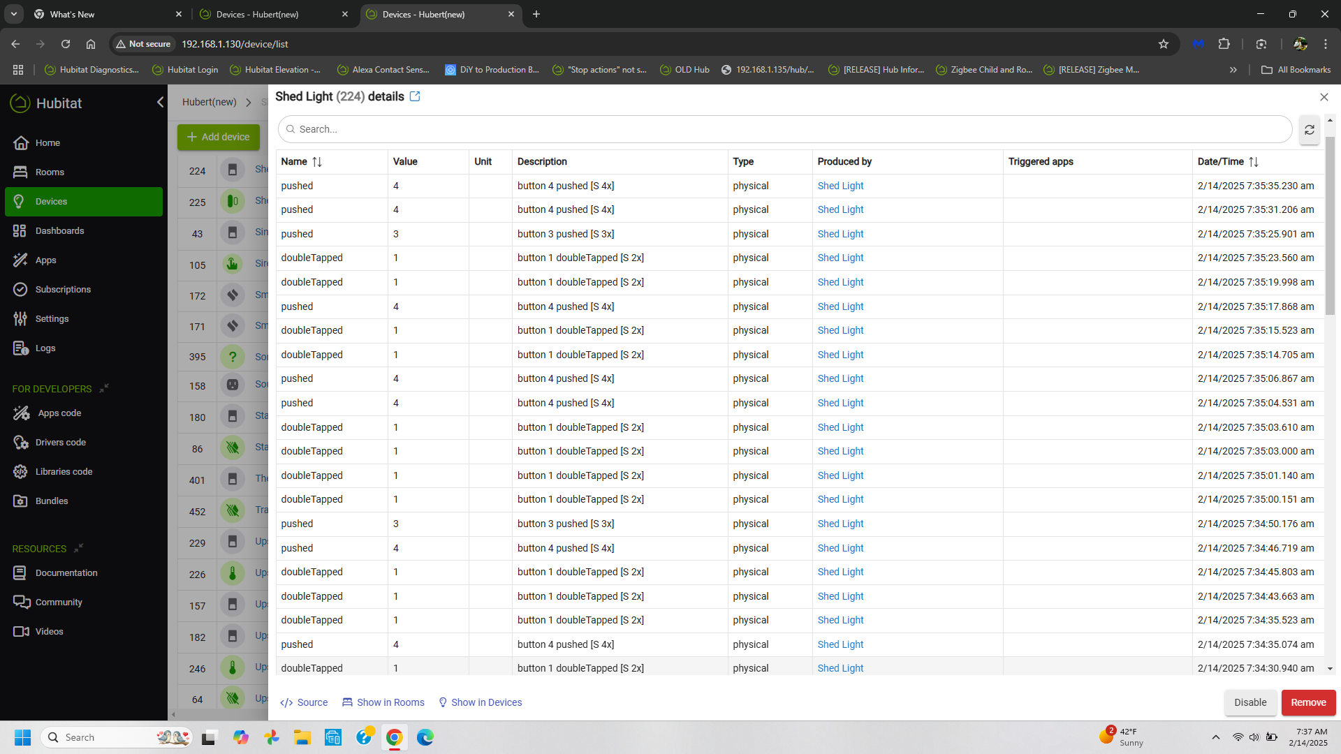

I noticed my zen51 shed light on this am, it is in the yard probably 60 ft from my house and hub. Looked at the logs and found lots of button pushes. Hit configure and they have since stopped. Have also in the past at times seen this switch not respond to the physical light switch flipped on or off but would work from device or app pages. Outside temp was 44, seems like it is cooler out when the physical switch will not control it?
I have not had the issue since setting parameter 27 to 0. Yay!
