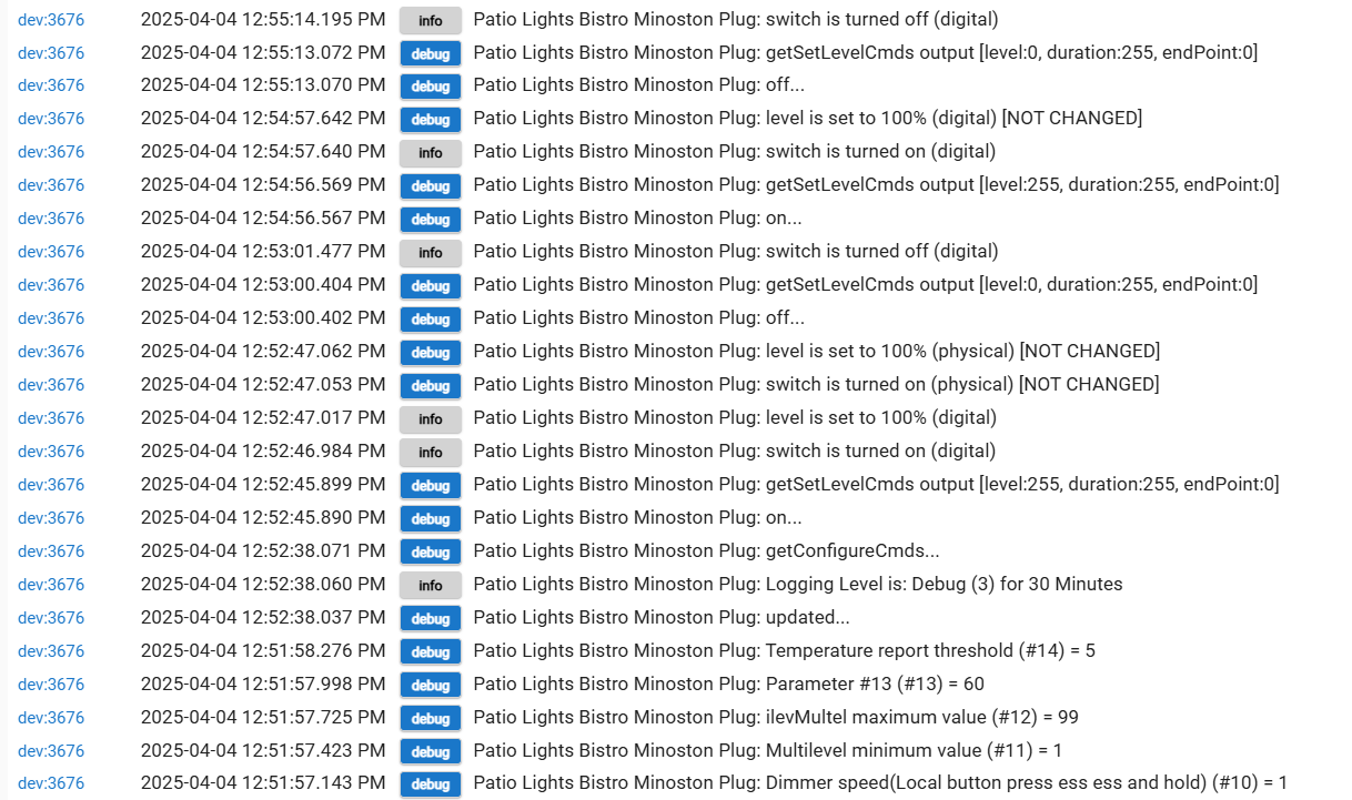

Assigned to a Minoston Dimmer Plug (MP21ZD) just now and things seem to work normally, no issues controling the light from the Device page or automations. Nice work!

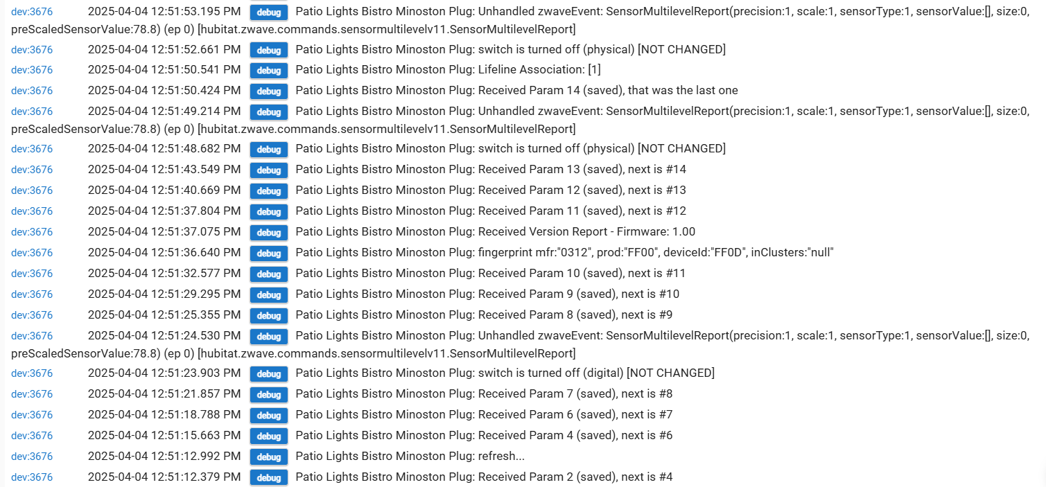

During initial setup, I hit Configure and then Refresh, sync completed and then prompt appeared w/something like "Refresh the page and then Save." Since I had just done a command Refresh I assumed that "refresh the page" meant reload the page, so did that, and then since the only "Save" option is on the Preferences page, went there and did a Save (though didn't change any of the default settings).

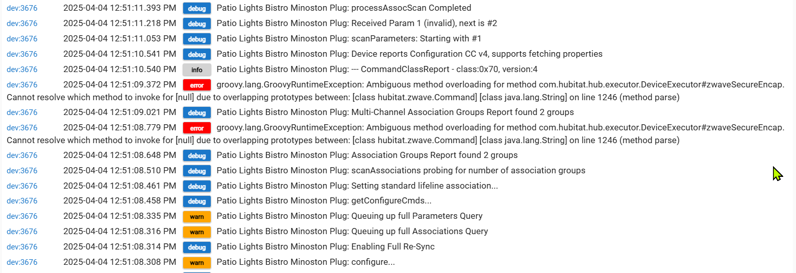

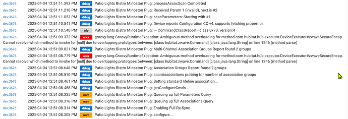

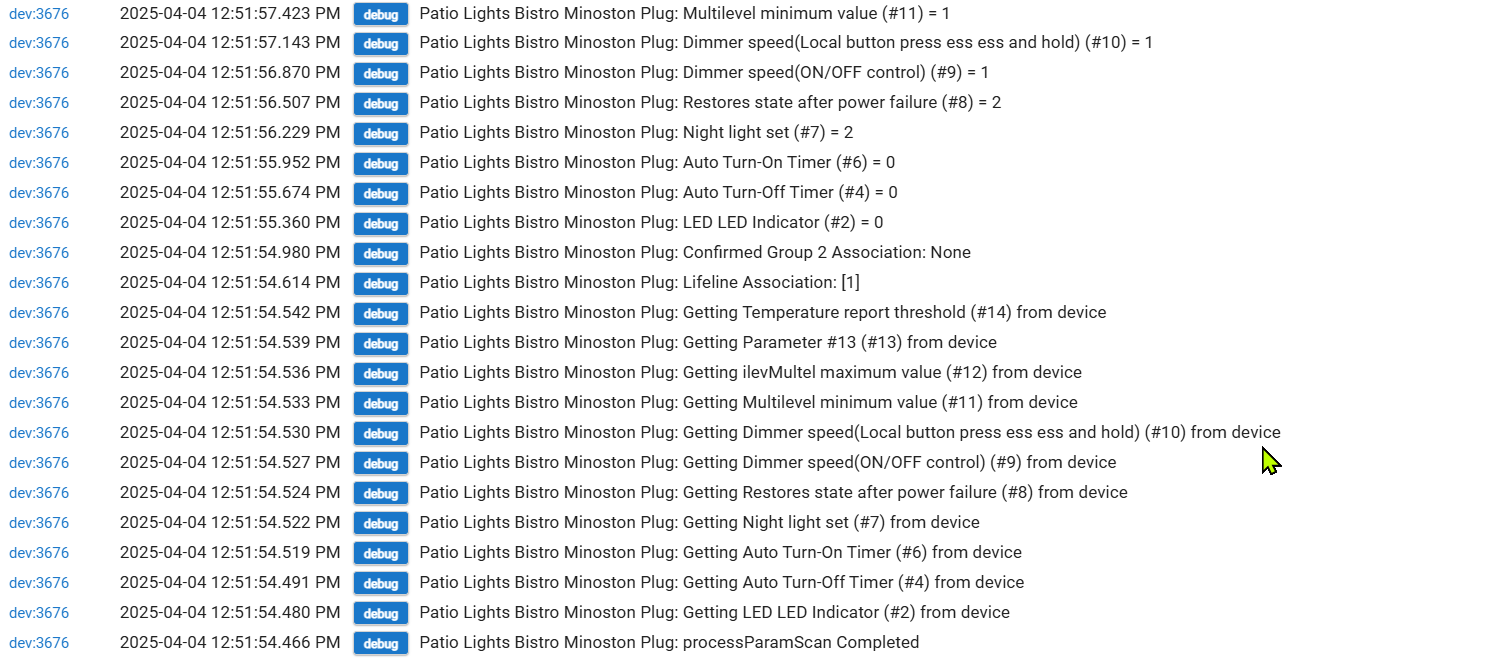

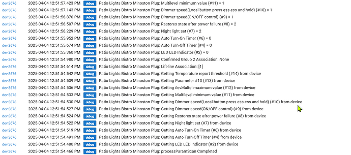

Wanted to post logs as had a couple of Error messages during the driver's initial configuration. I think those are due to the fact that the plug is included w/out security, no S2.
It's an issue with Z-Wave JS and how the platform code handles Z-Wave payloads coming from ZWJS. Had the same, it's not an error in @jtp10181 driver, but it needs fixing on the platform side.
My suggestion is to switch back to zipgateway (legacy Z-Wave) for the time being.
Thanks for the info.
I'm not having any actual problems using the Universal Dimmer driver (and this is the only device I'm currently using it with)...plug turns on/off directly or via automations w/out issue. All things Z-WaveJS appear to be working normally on my hub at the moment (plug actually seems to be responding faster). So rather than fall back to Zipgateway if some action is required I'd just switch to a different driver on the plug. :slight_smile:
But at this point from a device & general hub function perspective I don't see any issues w/letting things ride as they are...am I missing something? :man_shrugging:
The errors are when trying to get the association group names from the device. The command class I am using must be broken on JS. Also someone else found associations in general are totally broken. Everything else should work fine.

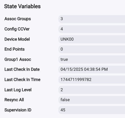

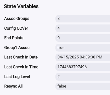

Possibly related to my previous report of issues with the switch to Z-Wave JS, I had six Z-Wave mesh devices that became unresponsive to Z-Wave commands. All six devices are Leviton ZW6HD 800 series dimmers, in mesh mode. One other dimmer of the exact same model came across and continues to work fine (I have seven of the Leviton ZW6HD in total).
I was using the Universal Z-Wave Dimmer driver and the interesting info from the driver's query/information capability is that the Leviton device is suddenly unknown ("Device Model UKN00"). This happened to all six problem devices but was not reported as unknown for the one working Leviton ZW6HD Dimmer.
Any attempt to interact with these "broken" dimmers through Hubitat resulted in an effective total loss Z-Wave on the hub (Hubitat went into a endless loop of reporting all devices timing out in the Z-Wave JS logs). I would have to reboot Hubitat to "calm" the network.
Broken:
Working:
The initial resolution was to exclude and re-include the six dimmers, but there was a "rub". Once re-included the dimmers worked as expected except that the Universal Z-Wave Dimmer driver could not correctly update state. It would cause device to turn on and off as commanded, but the reported switch state was always "On". Note, the one dimmer that was not broken is still using the Universal Z-Wave Dimmer fine. It's only the re-included dimmers that do not work correctly with UZWD
The fix to the switch state issue was to go back to using the built-in Generic Z-Wave Plus Dimmer driver. Using the built-in driver the dimmers work as expected - correct reporting of state as (de)activated.

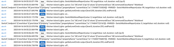

The issue is the 'null' duration that gets reported. Does the one thats working happen to have a 0s transition time set? That might cause the duration to be reported correctly, I have not tested it. Otherwise, maybe just luck and ZWJS somehow configured that one correctly. Would need to see the trace logs from the working one to confirm what is going on.
Ok, I stand corrected, the one that I thought was working fine is not actually working fine. While it didn't come across breaking the Z-Wave network like the others, apparently it's state won't update either, but unlike all the others, the "stuck" state was off instead of on. I should have done more validation.
With a little more testing, the device reporting state remains in whatever condition it was when the UZWD driver is selected which I suppose make sense since it's a data reporting/parsing issue.
I see the duration in the trace logs and I assume that maps to the "Fade on/off times". I've now tried 0-2 and the setting has no effect on the null. I normally use 0 (my wife hates the fade).
