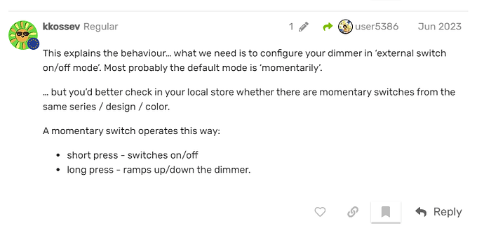

I have the dual gang version of the E and this driver doesn't seem to enumerate the second channel.
Also surprisingly the switch inputs seem to only support momentary and not toggle. I hope that something I can resolve!
Most probably your device is different than these, which are already supported in this driver.

Hello KKosev,
The driver worked.
The only problem that I have is that the mechanical switch should be like the one here that you commented before on an other post:
Is there any way to chage the external switch operating mode from momentarily to on/off.
I just got back from the store and I cant find a switch momentary for the same plate color and my wife will kill me if I dont match all her plates.
thanks
I was reading about the on/off and looks like there isno way to do so in the driver. @kkossev am I correct that can not be changed?
