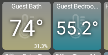

All my tiles use a single decimal value - ie: 74.1, 55.2. Your driver is reporting to tiles without the ability for me to control how many decimal places I want. The -02D reports back 2 decimal places - I myself use my tile apps to control/drop the decimal to 1 place. Your driver is reporting back without any decimals. Can you make optional or report the full value in your temperature attribute? You are giving 1 decimal to humidity so for me, we're all good there.
