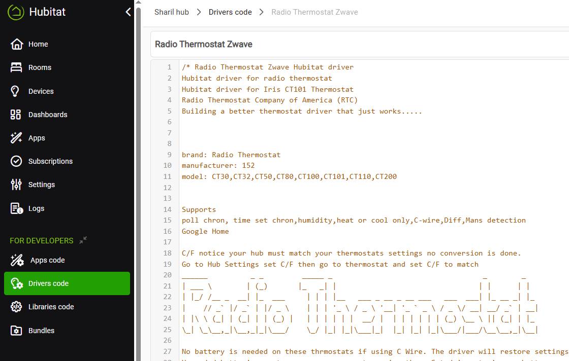

[DRIVER][RELEASE] Radio Thermostat Zwave driver

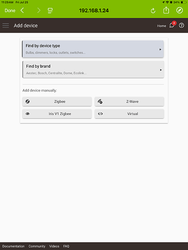

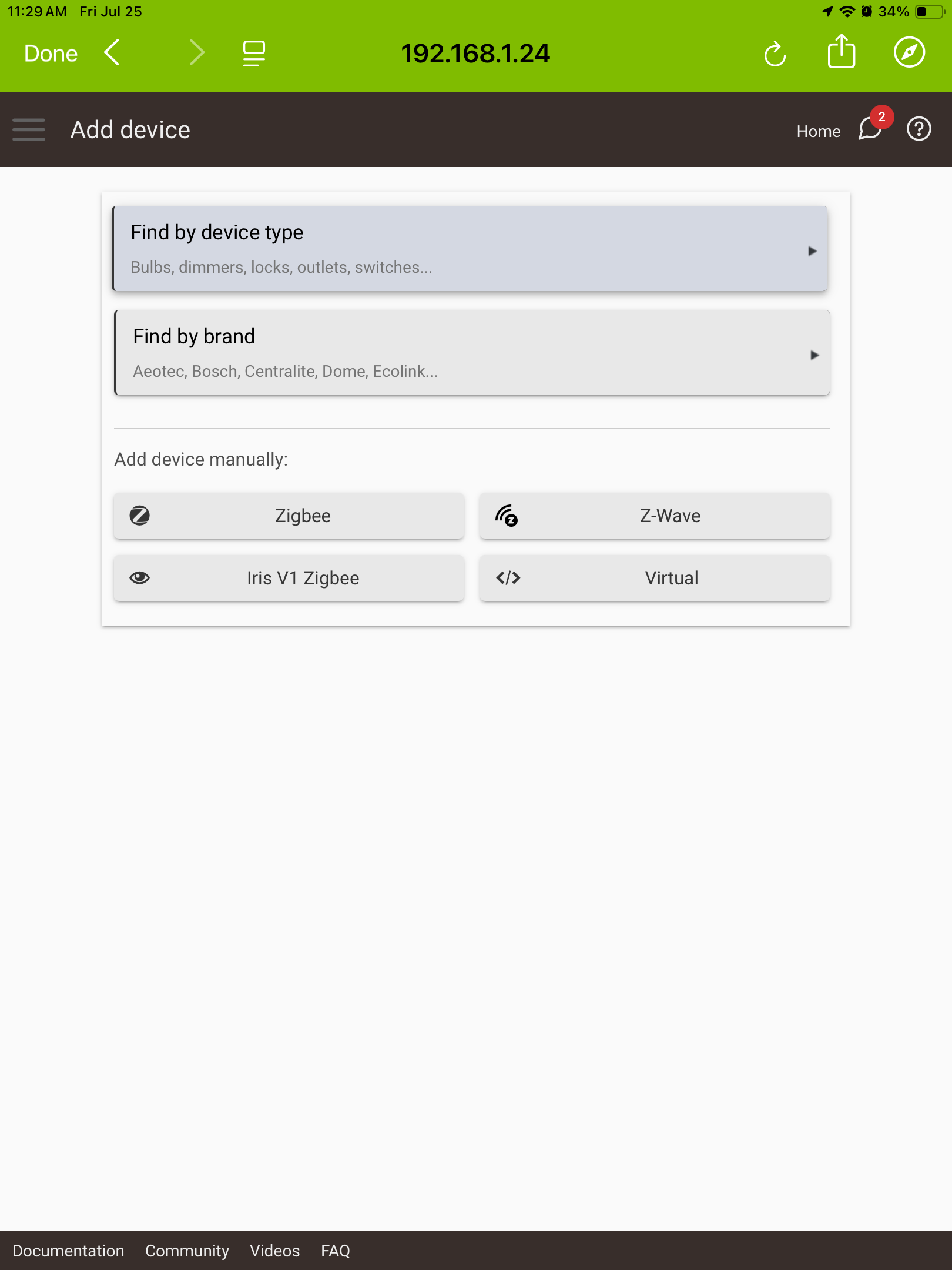

When adding it as a device what selection do you use? I don’t see America or see it under Iris.
You must add the driver under (drivers Code) then it will show up as a option when you add a device. If it ads as a generic thermostat just change to this driver
