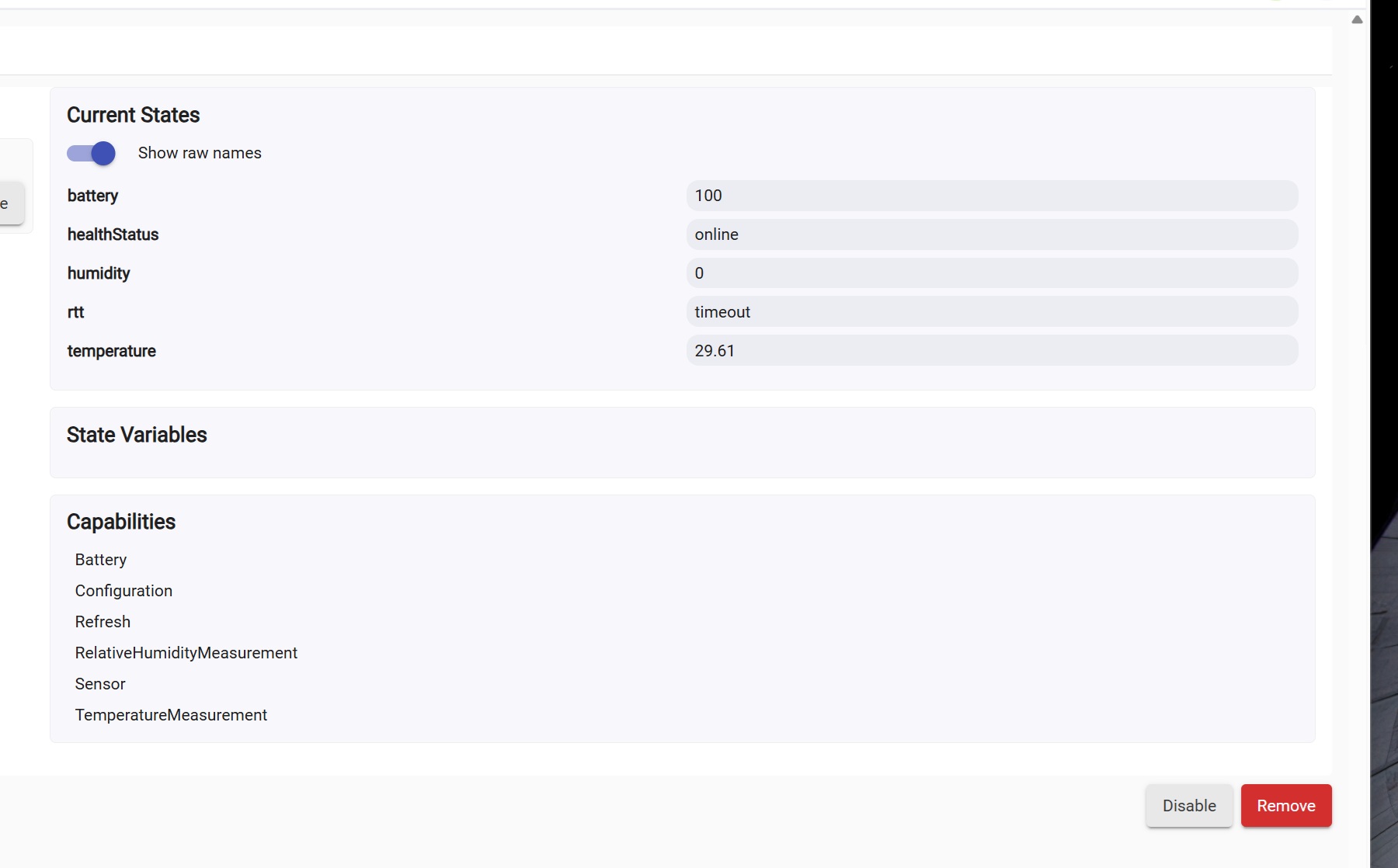

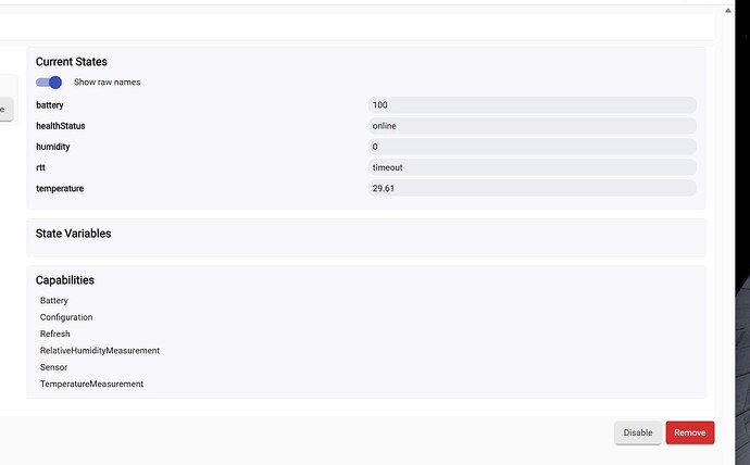

Hi.
I don't know why but it doesn't show humidity on mine using Third Reality Soil Moisture Sensor
