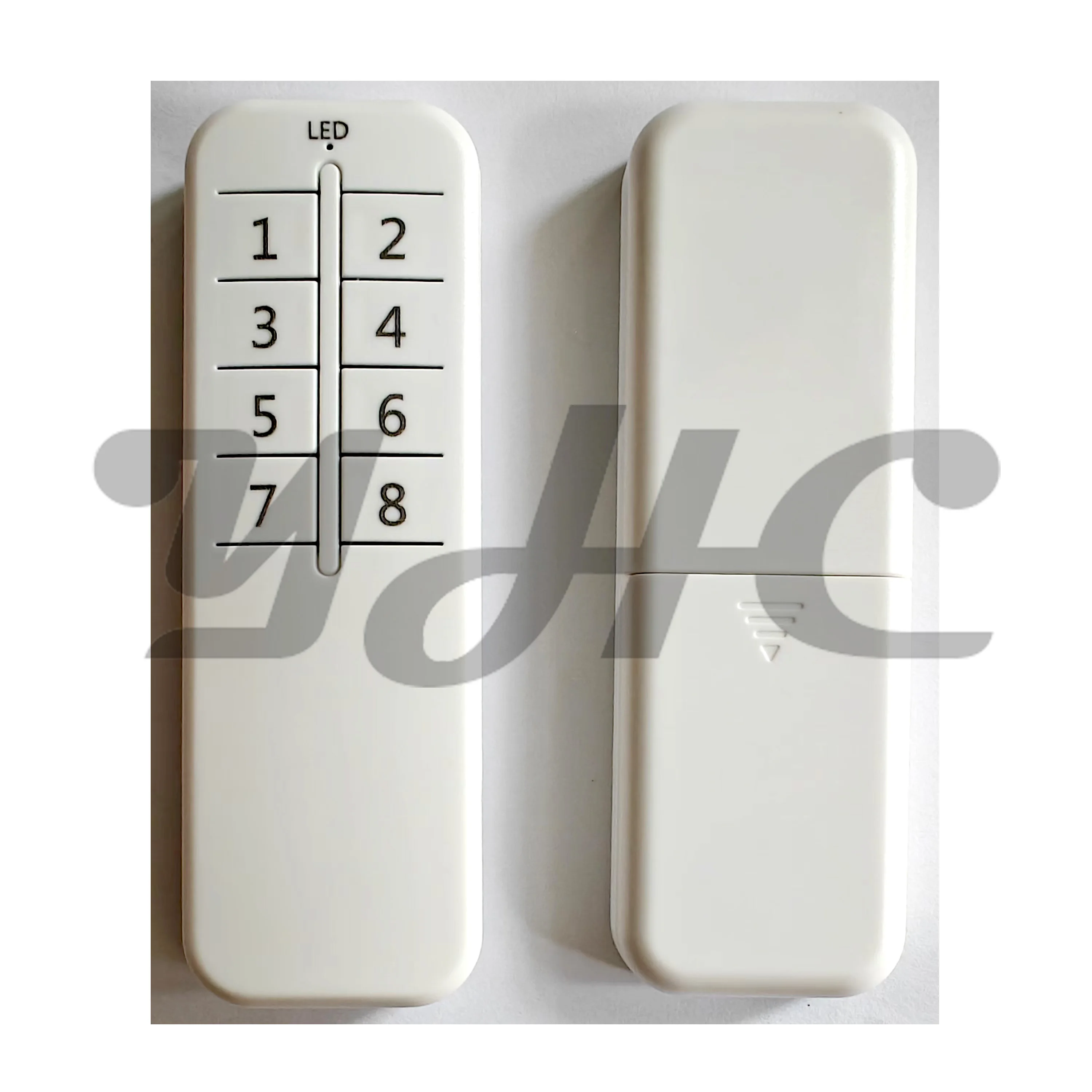

Driver for 8-button remote?
Just got one of these:
Manufacturer: Null
Model: ZB-WB08
Any suggestions for a driver?

Aliexpress:
https://a.aliexpress.com/_m0ZKXkn
YHC ZigBee 2 x 8 button remote controls OnOff switch scene control Zigbee IEEE 802.15.4 for zigbee2mqtt
The buttons have a nice tactile feedback, and I was hoping that this would be a nice addition to my Zigbee system.

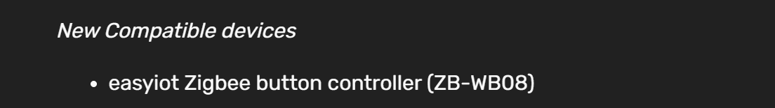

Now that there's a built-in driver for this.
Edit: Oops not quite yet.

Iโ€™m running Version 2.4.2.138, but I donโ€™t see a driver for this 8 button remote yet. Do you know the drivername I should be looking for?
Sorry, no idea. :person_shrugging:
Maybe @mike.maxwell might have some guidance.
I post a question to him privately, but havenโ€™t heard back yet.
Yeah, it didn't make 2.4.2.138
Progress today: the 8-button remote -- after re-pairing about 5 times after selecting the new driver -- seems to work!

I installed one 8-button remote and found that only buttons 1-7 worked. A 2nd installed unit has all 8 buttons working. Haven't tested a 3rd unit that I have.
The buttons have a good tactile feedback. The outer buttons (the part you press) are pieces of the plastic shell -- just tabs -- that simply flex a very small amount to push the working button switches on the inner PCB. It remains to be seen whether the slight flex will result in stress cracking over time sufficient to break off the tabs.
I'm satisfied with the fully working unit -- I control 7 lighting circuits inside and outside of my garage workshop and 1 fan, and I haven't made use of double clicking or holding yet.
