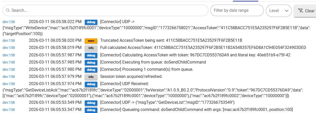

I do see a warning for a truncated access code being sent but no errors in the controller.

The Truncated access code is if you don't include the "-"'s mine is setup as 8digits-4digits-2digits ex 12345678-1234-12 if you are leaving out the "-"'s the connector relay won't accept commands without the correct access code to create the correct token

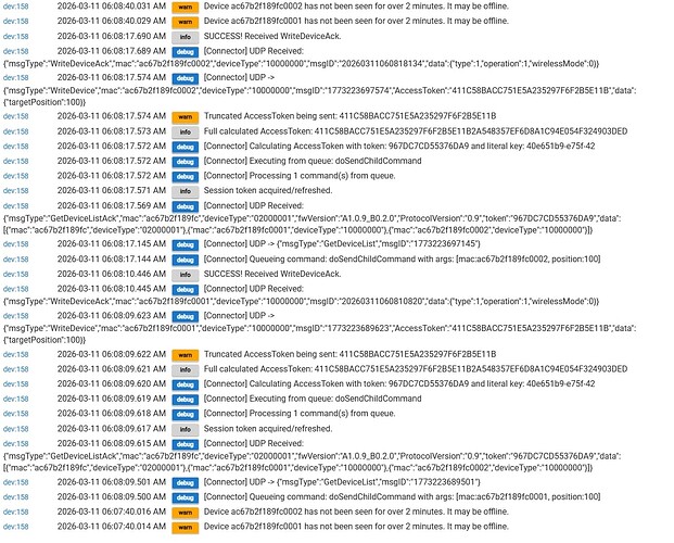

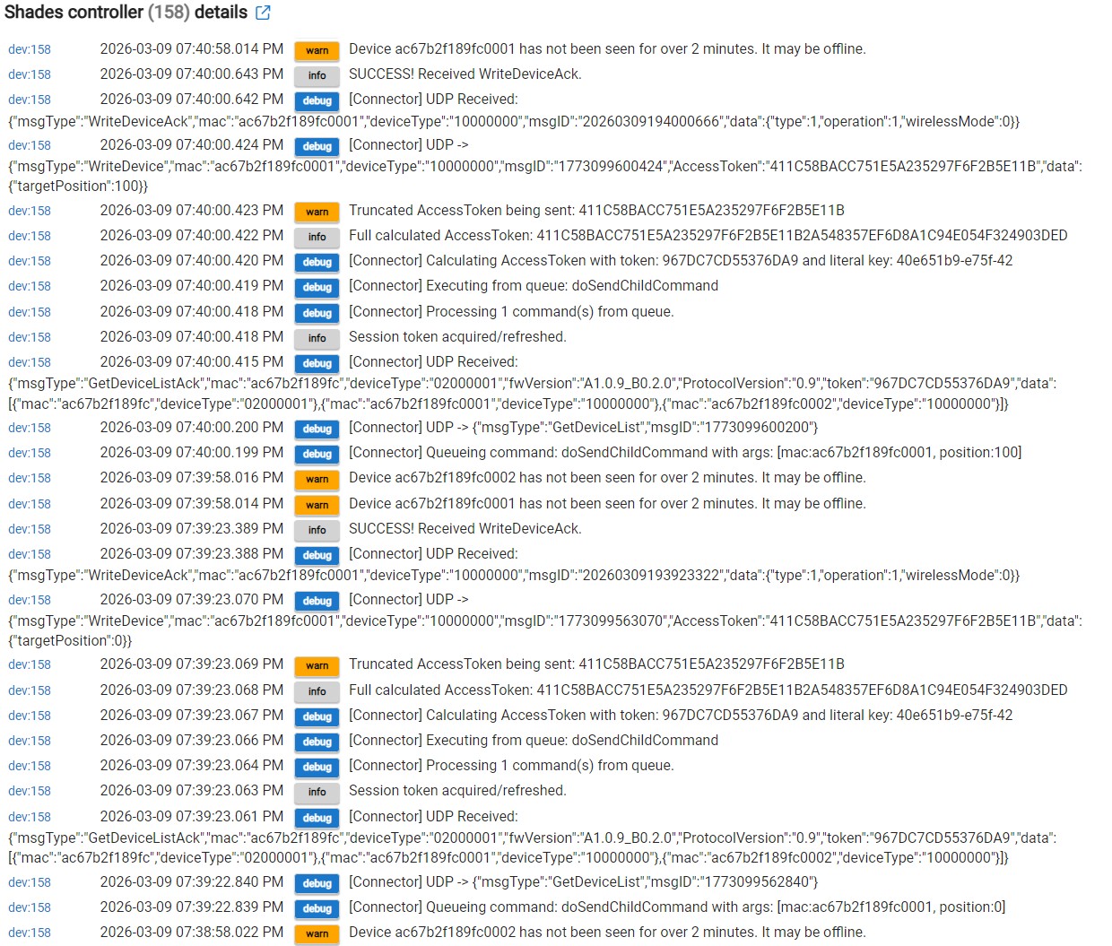

@scubamikejax904 I confirmed the Bridge Key does have 16 characters and includes the dashes. Below is a sample of the logs from the parent device.
It looks like it's receiving the multicast info from the connector hub. can you verify the model of the hub (is it the DD7006 P-Box) If it is what is the branding i'll try to lookup and see If I can find the specs maybe Different Branded uses different firmware/commands)
Mine is a Dooya 7002B Hub.

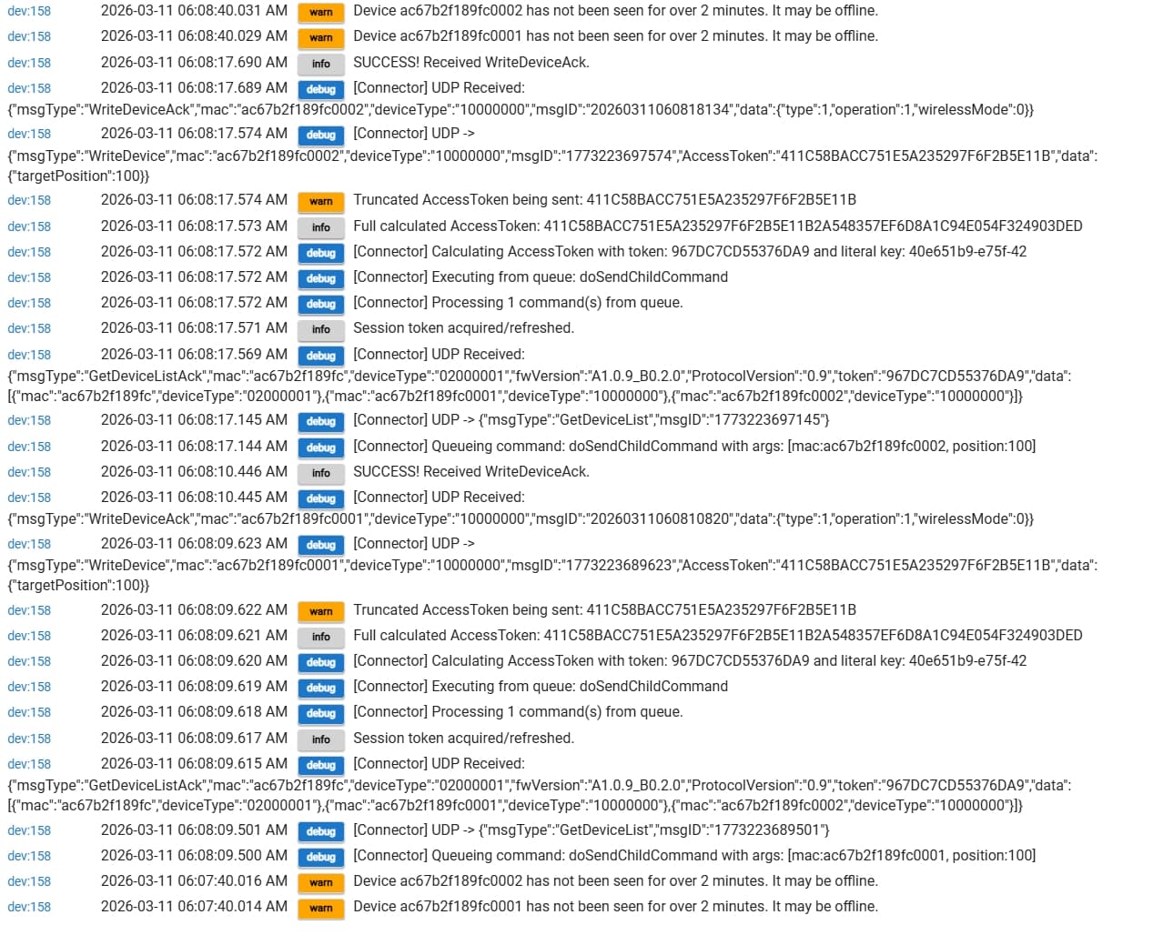

Update. Still no control of the children.
Thank you for those logs, sorry it's taking so long it's a slow process when I don't have the device to test. It looks like the other driver was truncating the token to 32 characters and the 70002B is expecting the entire 64 characters, this version should correct that

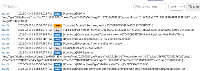

It appears a truncated token is still being sent for some reason.
Hmm on the preferences try changing hub detection from auto to 7002b I'm not sure why it's truncating the token it should be sending the whole thing. I'll take a look at the code in the morning and see what I can figure out

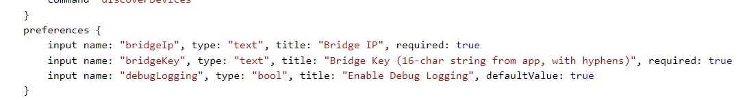

In preferences my only options are Bridge IP, Bridge Key, Enable debug Logging and Default Current State. I have no option for Hub Detection.
Sorry for the confusion I got ahead of myself. I am trying to make it so we can use 1 driver for both Hub versions (mine DD7006 requires the truncated token, and yours DD7002B requires the full token) I'm working on a new version for you to try.

The logs are looking a lot better. I configured as a 7002b and turned off the 2 minute offline warning. l am stil unable to control the children as they are reporting an access token error?
