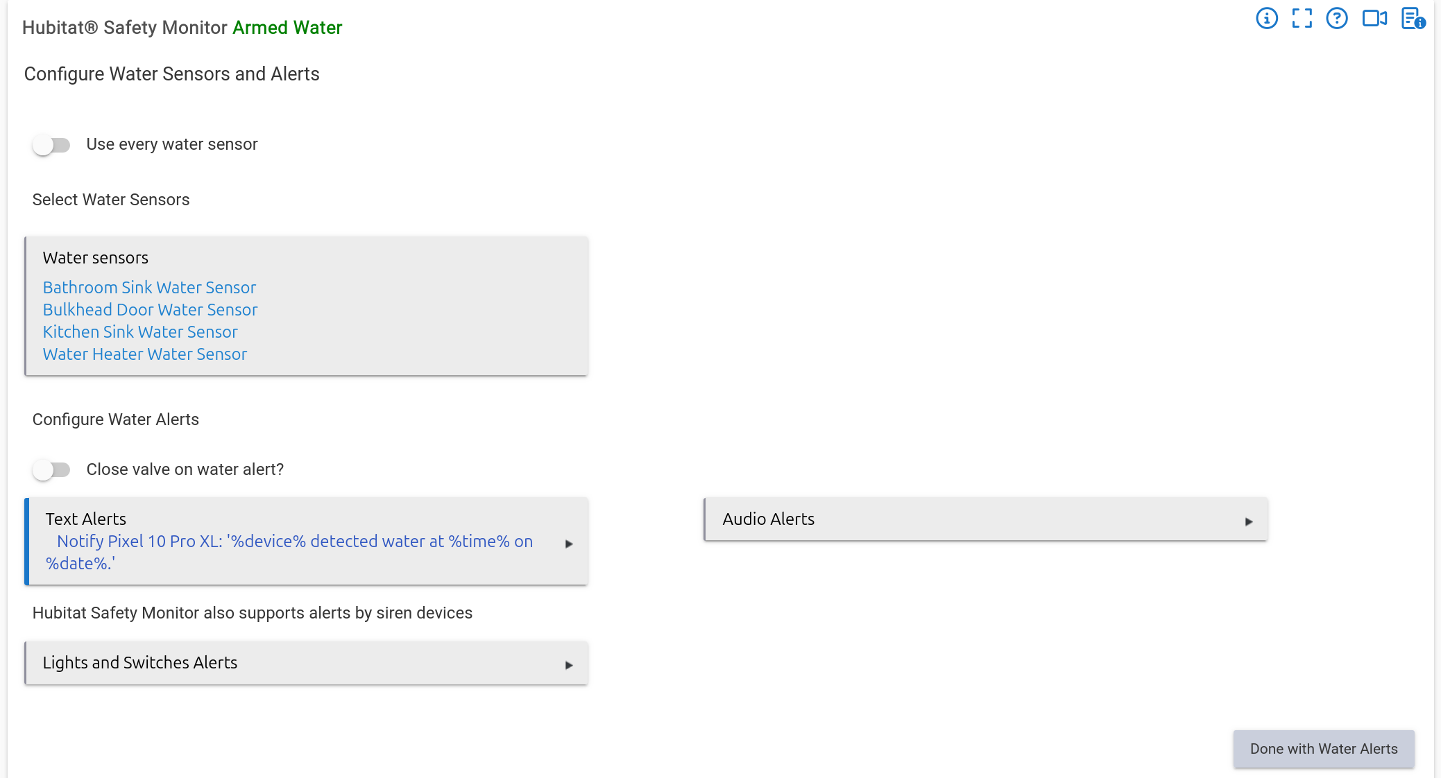

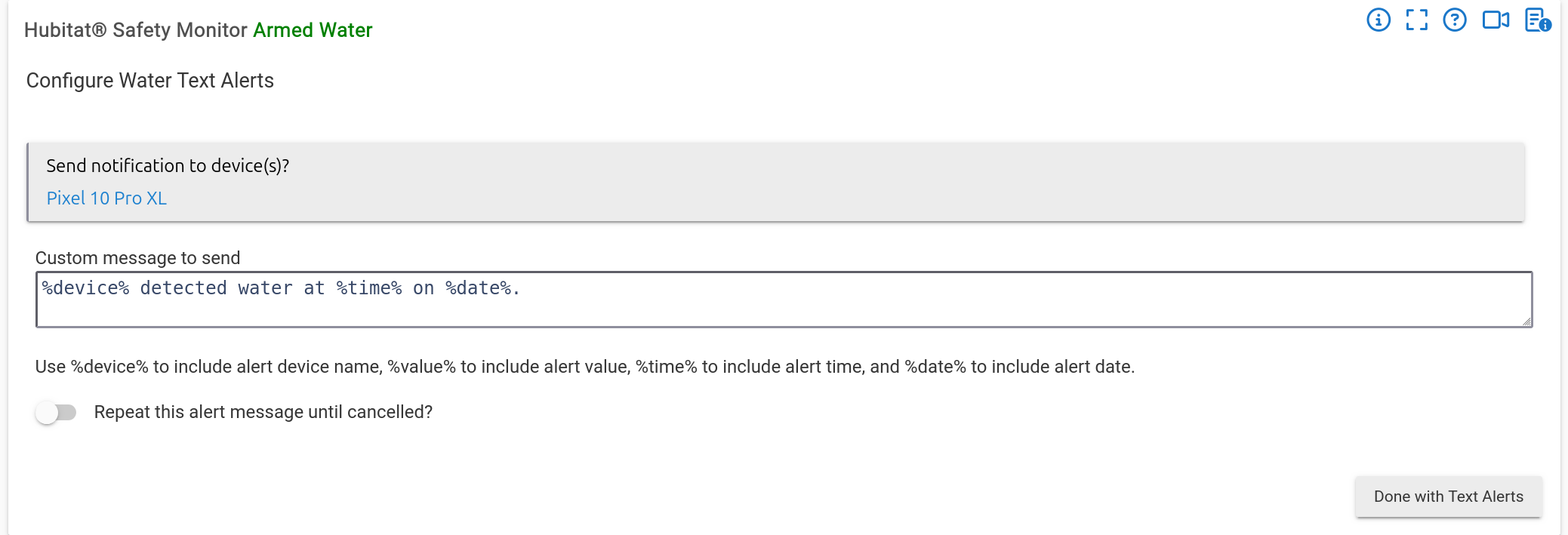

I recently installed Zigbee water sensors (Sonoff SNZB-05P) and set them up in the Hubitat Safety Monitor (see screen shots below). Within Hubitat Safety Monitor, I've got it set to send Text Alerts to my Android phone when water is detected. My Google Pixel 10X Pro has the Hubitat Android app version 2.1.4.07 installed.
