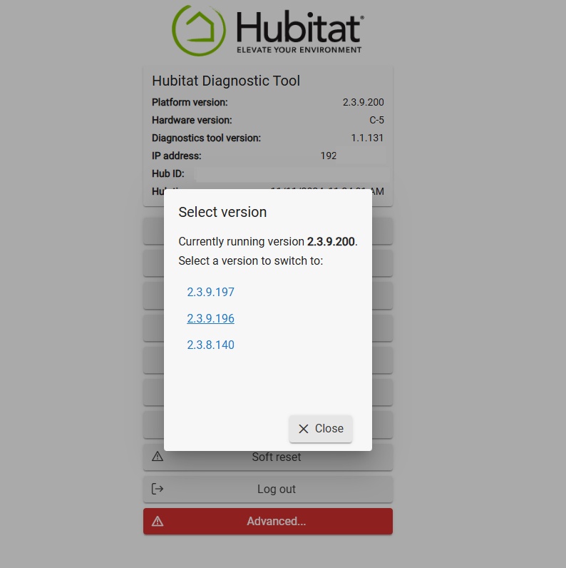

That was my reason for asking, I did go to the Diagnostic menu and picked for example 2.3.9.197 and when it booted back up I still had the 2.3.9.200 build installed.
Can you provide a screenshot of exactly what you're clicking on?
Sure here it is, I've done both the .196 and the .197.
The .197 when it restored it still says 2.3.9.200 messed up my Motion Detectors/Lights in the Master Bathroom and Closet and it took some time to get those working again, So I'm a bit gun shy in doing this again at the moment just because I have no other issues and don't feeling like finding out the motion detection and lights stop working again.

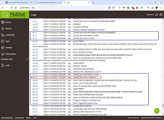

The actual issues is my Kwikset Lock on the Laundry door (which started doing this when upgraded to the .200 build) works perfectly fine if I use the lock button on the dashboard or mobile device. However I seen a few times now were the rule runs for the laundry door to lock it at 8pm and It doesn't work and I get back a unlocked status from the laundry door lock I assume. So I manually push the button on the mobile device or dashboard and it locks right away.
Note below the rule running in blue area and then in red it gets back unlocked. I then 2 minutes use the dashboard and select the lock and it locks fine.

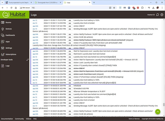

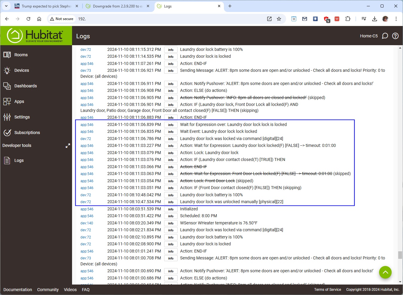

One last thing, I then unlocked the door manually and run the rule manually and it worked fine as shown below at 8:11pm
