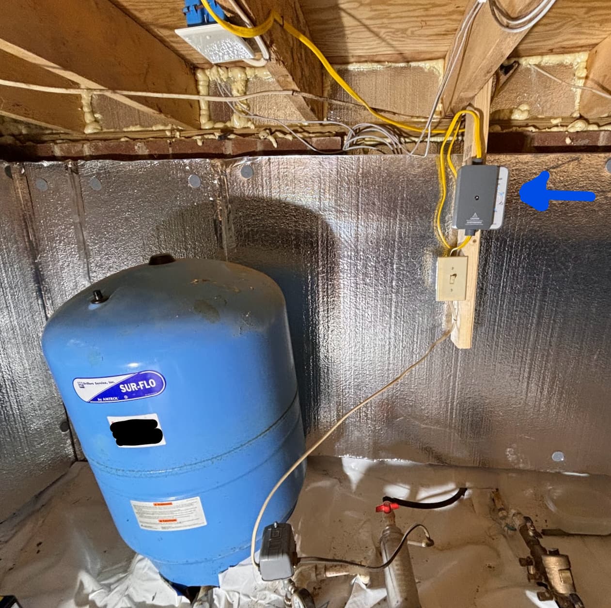

I recently installed the Sinopé for my well pump and am very pleased with it.
I wish I had been monitoring my well pump before. It would have saved me about $6,000 by telling me my well pump was running frequently in the middle of the night, indicating a leak. Instead, I found out after the well pump had worn out from running continuously.
