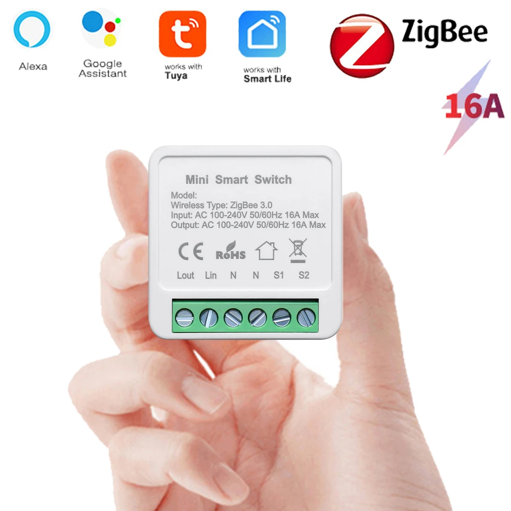

Is there a dual in dual out zigbee relay working with HE?
Now i have THIS but i can handle only one input and only one output with a generic zigbee switch.
Thanks for the help
Thanks for the help

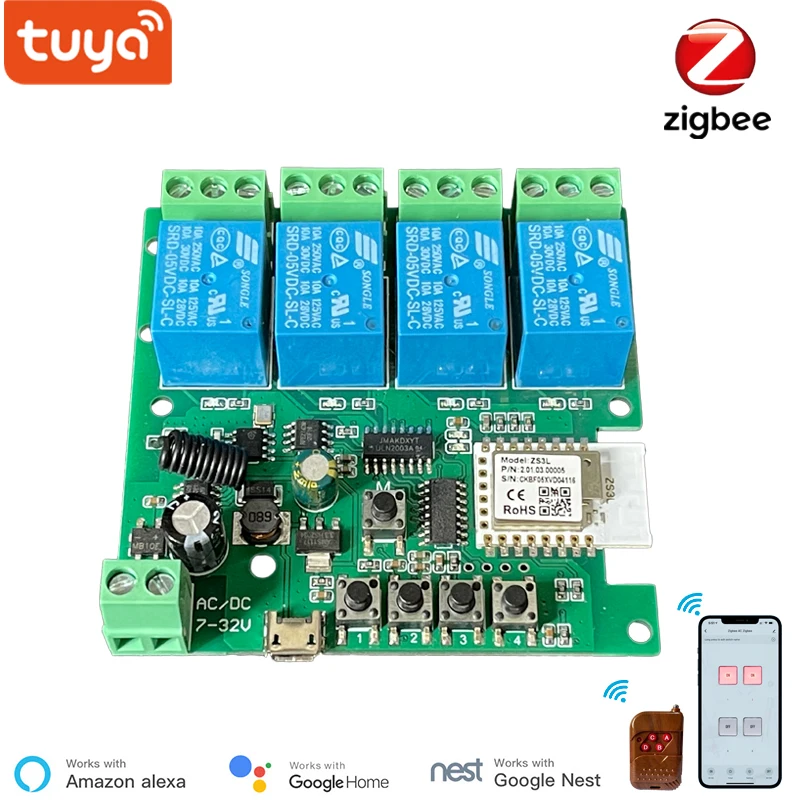

Hi, i have a chip aliexpress zigbee switch board x4 channels.
I first tried to use the generic zigbee switch driver but it activated only a single channel (the first)
I then tried to change the driver to generic zigbee multi end points, as recommended in this post. However now when i click on/off my HE hub turns all channels on or off one after the other. There is no a specific push button per each channel.
Please advice how can I fix this issue.
Ariel
See below links for the zigbee items:
After changing the Driver Type, did you click CONFIGURE?
Also, what should have happened is multiple Child Devices should have been created under the main 'parent' device. Each of these child devices should control one channel on the board.
Note: I do not have the same board that you are using, so I cannot confirm whether or not the "Generic Zigbee Multi-Endpoint Switch" driver is going to properly work or not.
Hi, i tried to click on the configure before but nothing happened. When i enter the device now is was charged exactly as you described.
I guess it had some delay?
Anyway i check each channel and it works great!
Thank you so much!
