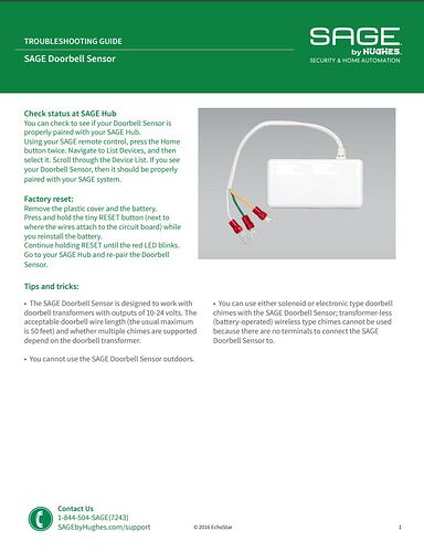

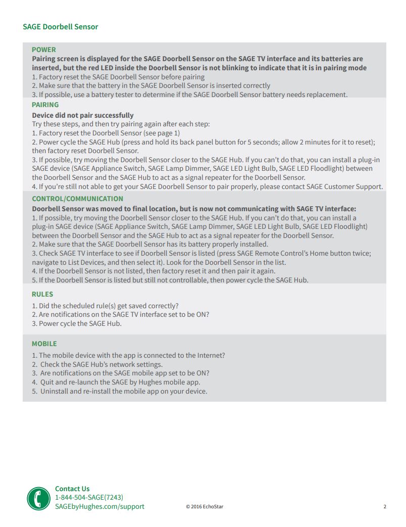

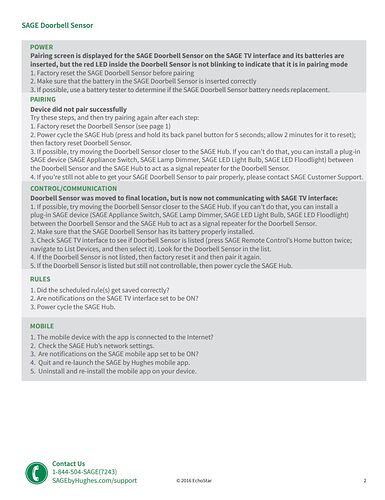

I just picked up one of these sensors on ebay the other day and after a bit of tinkering, I managed to get it working in openHAB.
Today I have just changed my Zigbee coordinator as I was having reliability issues, with doing this I have had to re-pair all my devices but I can't seem to pair with the doorbell sensor.
Would anyone have any advice on how to get it back in pairing mode? I tried the tiny button but it didn't seem to do anything, I have now taken the battery out, and on restoring power, it just flashes, which I assume is pairing mode but scanning does not find it!
I hope some has some advice, I can't seem to find any information about it anywhere!
