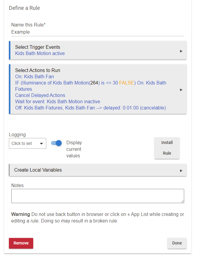

As a general rule, the best practice is to K.I.S.S. (keep it simple stupid :wink:). Using two rules to achieve what you want is sometimes the best option especially when they operate different types of devices. Although in your case it would seem a rule that is based on a single trigger (motion) wouldn't be that complex in RM either.
That being said, RM is a much "heavier" app, it's designed to allow much more complex rules, If you can achieve what you want with one of the simpler apps then that's fine too.
EDIT: I just realized you specified not turning on the light if it's already ON, in that case you would need a slightly different RM rule for the 2nd action using a "Conditional IF-Then-End" based on the current switch state and room illumination.

"Wait for event" stops the action execution until the next event occurs, but does not stop the rule from being triggered again. If it's triggered again the "wait" is canceled.
While I understand your desire not to turn on the light if it's already on, in practice I haven't observed a real-world improvement from trying to eliminate the redundant command.
The hue motion sensors have an adjustable motion reset that could help prevent the rule from being triggered so often, or you could use the "zone motion controller" application to create a "virtual" motion sensor that has a much longer reset.
