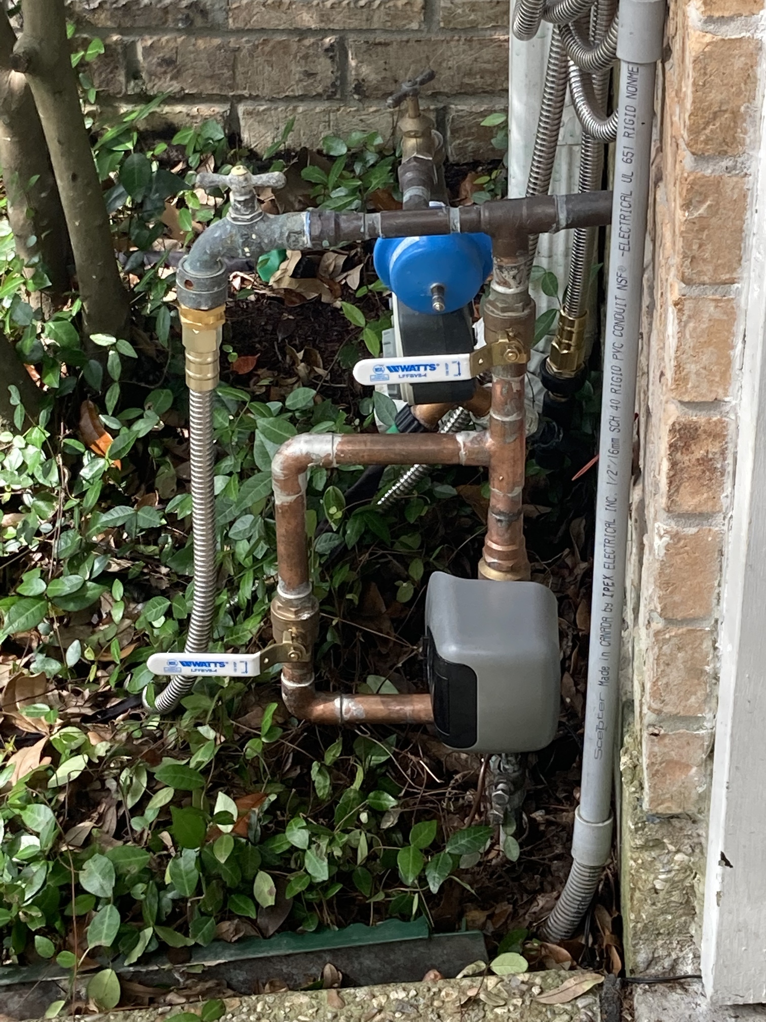

If I were in your place I would add both a manual valve and a Zigbee / Z-Wave controled valve. When water is squirting out somewhere requiring manual shutoff an easy to access manual valve will be very handy.
Agreed, this is what my Leaksmart setup looks like. I have a bypass to turn water on if the LeakSmart is stuck in the off position, and another manual valve to turn the water off if the LeakSmart doesn’t shut.
I’ve never had to use either yet in 6 years. This photo is old - from when the LeakSmart was installed - that’s why the copper isn’t oxidized. I also have a relatively water-proof box that fits over the whole setup.

Bear in mind that it can be stuck in the on or the off position. And should that happen, it is useful to have a bypass loop with a manual valve as well as a manual valve in line with the automated valve.
good call, i was seeing the valve in the parallel loop, but didnt notice the valve in-line after the loop... thanks for that.
