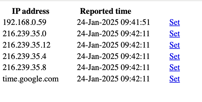

Works for me ...
Screenshot 2025-01-24 at 9.42.32 AM

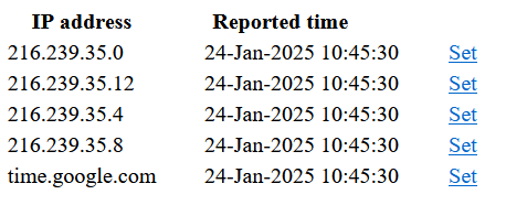

This is what I get with the Hub blacklisted on the router:
This is what I get when I whitelist the Hub:
Conclusion: Blacklisting the Hub from web access could possibly simulate a pulled ethernet cable.
Not really. If you block the hub from accessing the internet, it can’t access anything outside your LAN. Like the time servers in your second screenshot.
