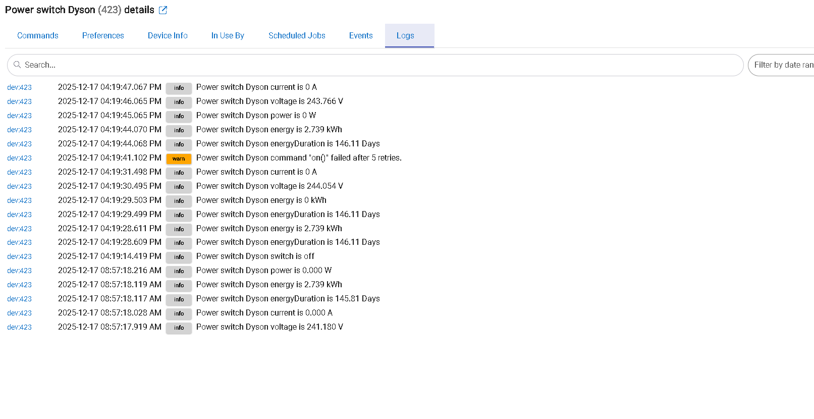

Aeotec smart switch 6 does not switch correctly using z-Wave JS and remotec scene master never changes from pending even when power cycle unit and hub an wait for 1 week
Did you try excluding and then inclluding again or manually teiggering the re-interview?
When I finally bite the bullet and upgrade my C8 to a Pro, I'm really looking forward to all of the shenanigans with my various devices...
I did try re triggering but did not exclude/ include, tried this a few months ago but as I don’t have non production environment I can not continually keep attempting this task, easier just to change back
