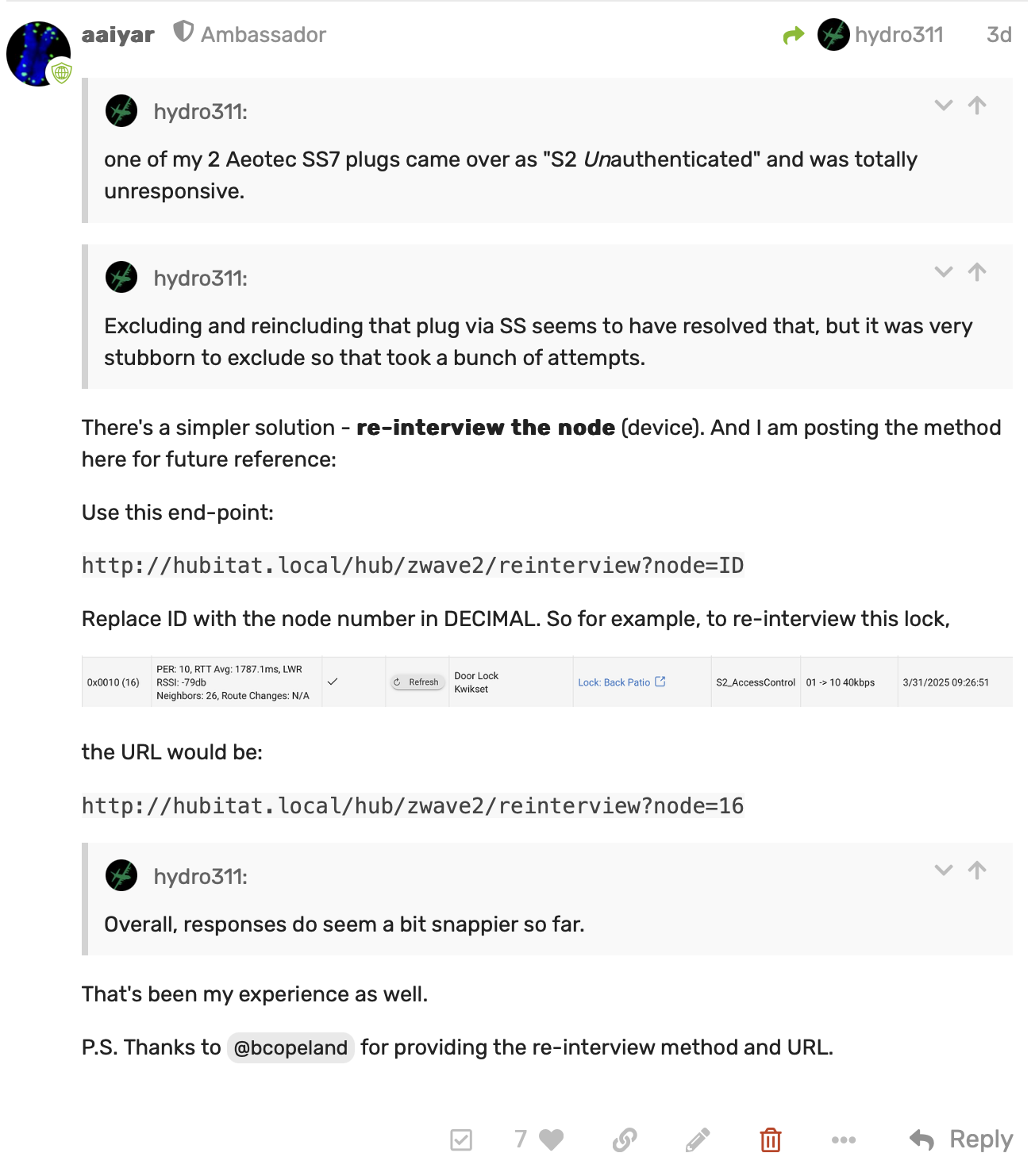

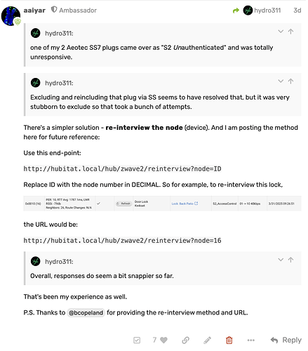

If you have battery powered devices, you're going to have to wait until they wake up and get re-interviewed in order for them to work again with Z-Wave JS (really applicable to all devices, but the mains-powered ones should be awake and listening for it all the time, anyway, and non-secure devices might still work without this but S2 devices will definitely need it). Without more information about what problems you were actually experiencing, I cannot say for sure if that was your problem, but it's a common cause of "problems" immediately after switching that will be resolved on their own or with manual wake-ups if you want it to go faster. There isn't anything that can be done to fix this, as it's just how it works, but it is mentioned in the notes on switching.

The solution is directly below your post in that thread. As @bcopeland indicated, you need to reinterview those devices. Here's a slightly more detailed description of how to do the reinterview.
Also, be sure to wake up the ZEN37 scene controllers before re-interviewing them, as indicated by @bertabcd1234 in the post directly above yours. As he also mentions, the need to wake battery-powered devices up is indicated in the ZWJS migration documentation.
Got ninja'ed by @bcopeland. But he describes the wake up procedure for the ZEN37.
The key thing to note is that you do NOT have to exclude and re-include any devices.
The device should automatically re-interview immediately after the wakeup, since it hasn't been interviewed by ZWaveJS yet.

But his Leviton switches will need to be reinterviewed - if they show up as S2 unauthenticated.
