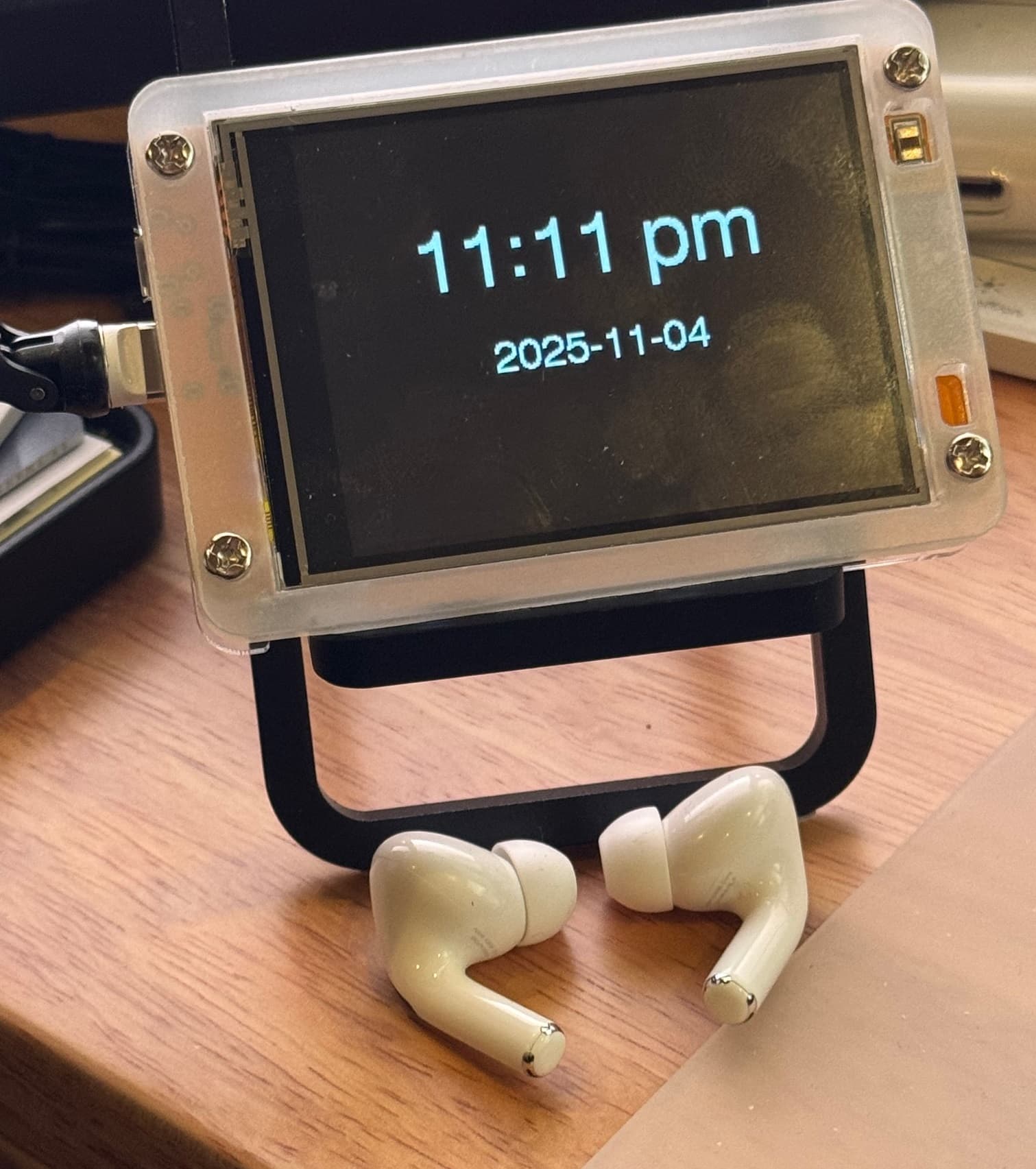

* Real-time clock displayed (synced via NTP) after the display is cleared

I got the touch screen to work, Claude originally used the wrong SPI bus. I've appropriately chastised him.

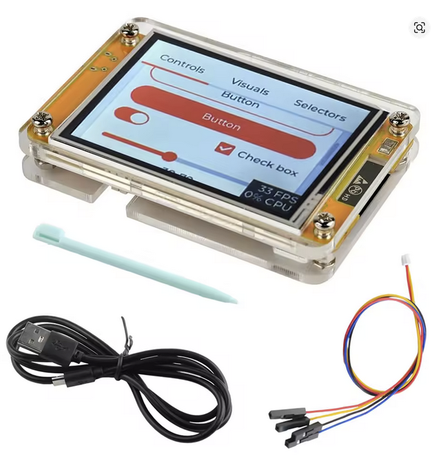

BTW, here's the kit a bought, which comes with the extra frame:
ESP32-2432S028R device (chip type ESP32-D0WD-V3, revision v3.1).
