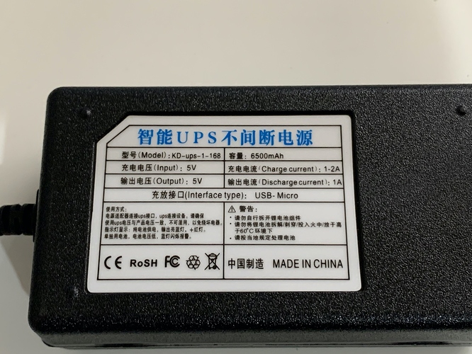

I also got my Yum-Cha USB UPS too - I immediately applied classic Dave Jones "dont turn it on, tear it apart!" to it.

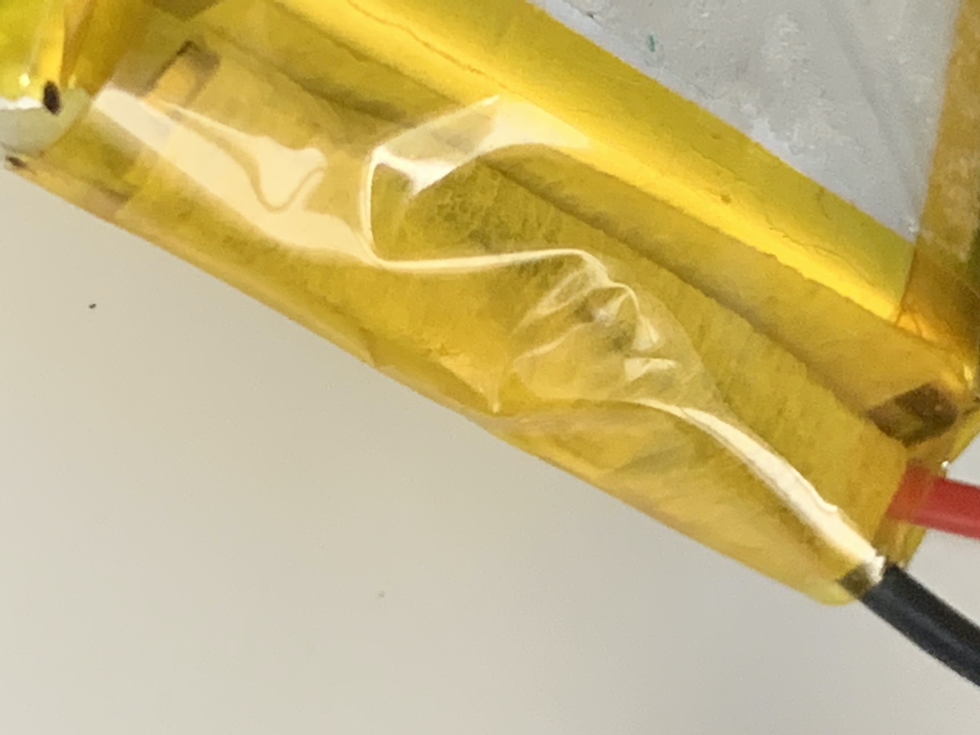

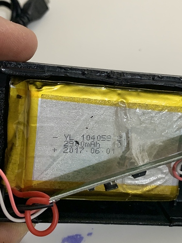

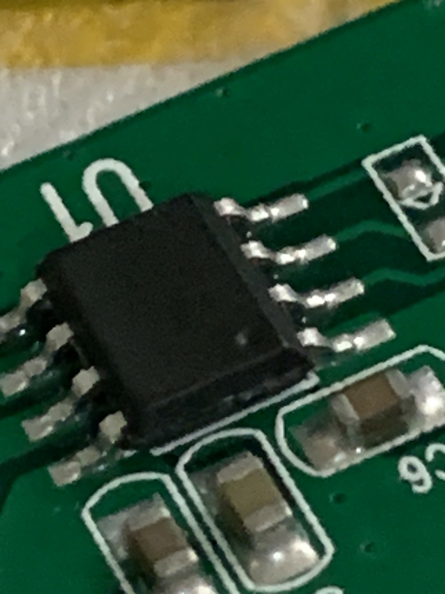

I was hoping it used a pair of 18650's that I could easily swap, but it's using a blasted pouch cell! And in no surprise to anyone, the 6500mAh spec is BS, it's a 2900mAh pack! The chip is unmarked too so I have no idea if it could support charging a pair of 18650's in parralel (I might try this anyway).

Using 18650's directly in parallel is not a good idea, if one fails it will start sucking power from the other one.
Good point, I might put just 1 in. I need to look at the board in more detail as my cells don’t have built in protection.
I don’t think the pouch cell does either so I’m hoping the circuitry has some on it.
Unlikely, but it's easy to tell if there's a small circuit board where the terminal cables are. Dual parallel packs will have them.
Hard to tell:

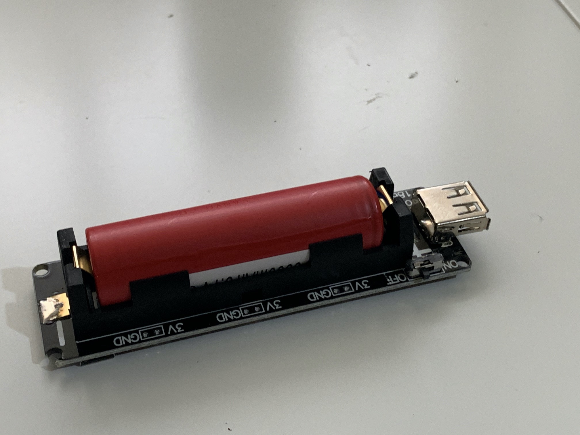

The board doesnt really inspire confidence, I might drop the 18650 board into the case instead. ![]()
Looks like a direct connection to the pack, does the UPS actually charge and supply current at the same time?

Yes it does. Just looking at the layout and probing it with my DMM, it it supplies + direct to the chip on pin1, it then passes the + out via pin8 and - in/out by pin7. The battery powers pin5 by a via in the pad.
So yes it does charge and output power at the same time.
I just did some quick and dirty power stability testing and yeah this thing drops power for long enough to cause an LED to blink. So definitely not recommended for HE's.
The single 18650 board appears to maintain power even in the fraction of a second after source power is removed.

If you are talking about the photo with the 18650 showing the On/Off only controls the USB output not the side wire holes. At least mine does.
