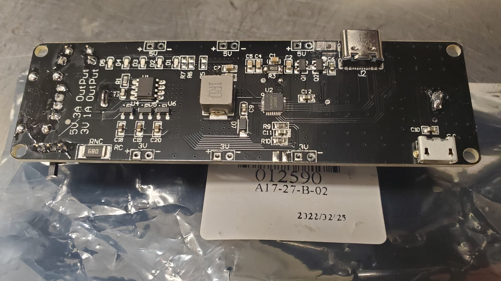

I just received my board from that link, and it looks like they have changed them. The board looks slightly different, and the output turns off for about .75 seconds when disconnecting input power. It then turns back on and runs on battery. Pass through charging works. This won't work as needed, however.
Just wanted to let others know.
There are at least two different boards I am aware of. I've not used the one you posted so I can't comment but I know the board in my post #277 works fine. I've looked at each IC and the circuit and understand why there is not glitch when power switches from/to battery.

The one i bought was from the link in your post. That's why I was posting as a public service announcement to let others know that the vendor has changed what they are shipping. Even the picture in the store link is different than what they sent. Maybe i will send them a message and see if they still have any of the other ones as they are pictured.
I found the version I had became hard to find. I think when whomever makes these boards makes a "LOT" of boards. The seem to be selling from numerous ebay vendors. And when there are all sold... their gone for good.
However I was recently looking for something and came across these boards on a vendor site I felt could deliver them. However I don't recall where.
I did find this link on Amazon It's still only going by the provided photo but at least you can return it to Amazon. Or you could ask the vendor before purchase.
I ordered the one in that amazon link, and it does work as needed. Thanks.

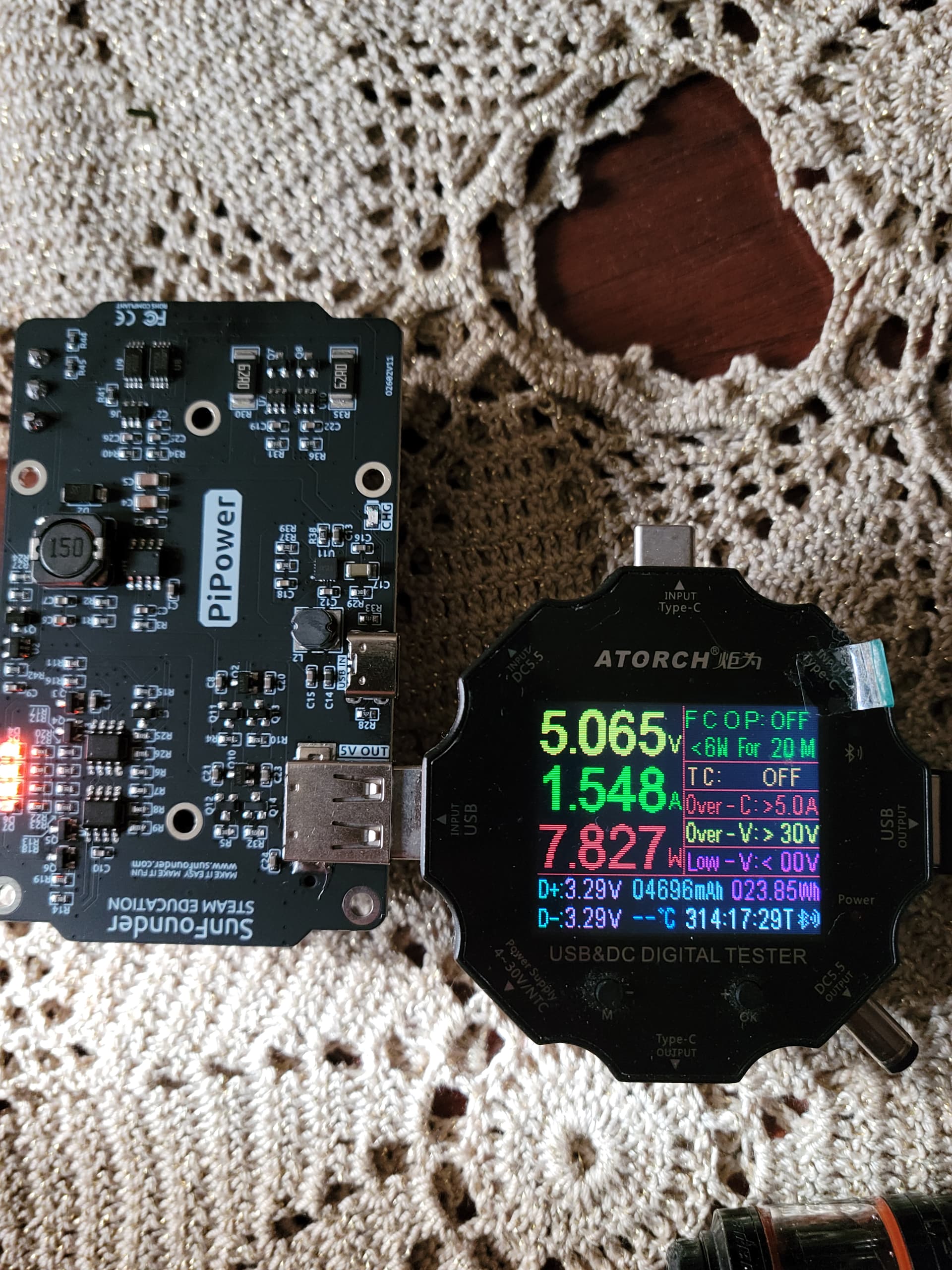

Found this on Amazon looking for a longer run time. Cost is about 20USD. It takes 2 x 18650 cells and appears well made. It has a much higher charge rate and I observed output up to 2 amps(not that we need that) and it charges quickly compared to the single cell version. I'll be testing it and posting more results.
https://smile.amazon.com/gp/product/B09QKJTQKJ/ref=ppx_yo_dt_b_asin_title_o02_s00?ie=UTF8&psc=1
Okay, so I let a C7 hub run till the batteries were dead, it was 24 hours run time. It seems to me, based on casual testing, that the circuitry in this 2 cell version is less efficient than the single cell version, which ran for over 13 hours IIRC
Rookie mistake, I used 2 high power Samsung 18650's(3000mAh) versus the 3500mAh panasonic cells in the single cell version. If I can find 2 newer panasonic cells I'll retest with those.

Has anyone looked at this? Wondering if this is worth pursuing. I'm sure someone could do a 3d printed enclosure easily enough
That looks really good, I’ll take a look at the design and look into the BOM costs tomorrow.
If it can be built for a reasonable price, I’ll make them available on my Tindie store.
Looks nice. For 20 USD the Pi Power seems to be an economical solution, although I like the design & battery handling of the device you linked.
