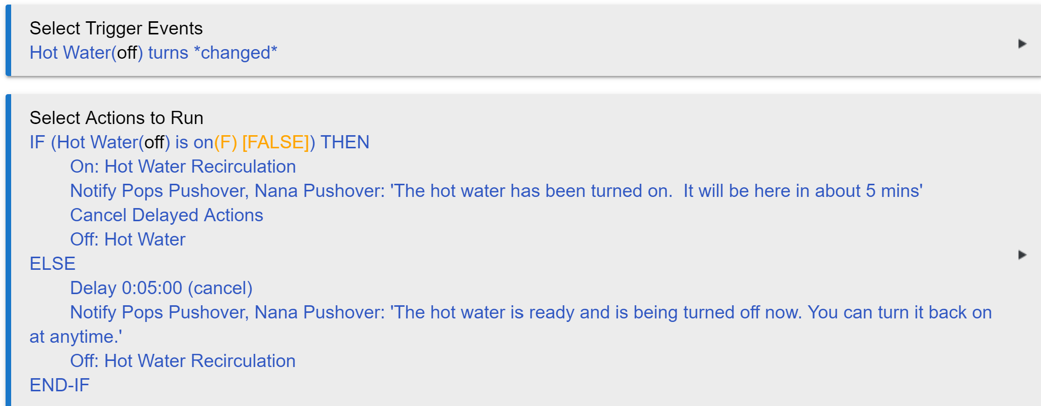

Do you have a hot water recirculation pump? If so you could time the dishwasher start about 4-5 mins after it turns on, this way you have hot water at the washer when it starts.
In my case, my hot water recirculation pump is plugged into a smart outlet and we can call for water anytime we want for showers, dishes...
Have fun
Rick
I am not sure about the recirculation pump, mine just runs lol...
I guess that's the point, why have it run all the time?
When we moved into this house, mine was running 24/7 as well, not even a timer so I installed a basic manual christmas timer. That was fine at first but it seemed like we always wanted hot water when the timer wasn't set to run so I bought a plug in z-wave outlet and now we have hot water only when it's needed.
Provided only to spark some thoughts
Rick
