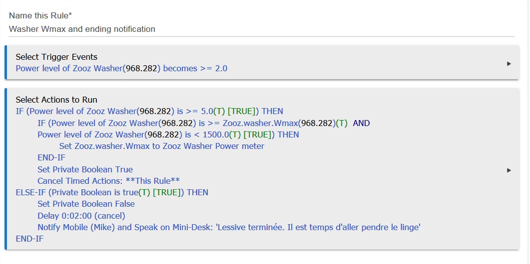

I'm not that familiar with all those if's in your rule, but look at this and then customize your own rule with your own settings. Mine is running without errors since implemented. The delay is important to avoid false alarm (more messages than expected).

It won't work since the trigger is > 10w and the if is >10w. Change the trigger to power changed then your rule will get run.
Of course you'll then have to change the first if, since you'll be called repeatedly and can't have time nor the PB in there. Need more help?
Your rule will never fire...
You first if checks if PB is False and sets it to true. The next part of the rule is an Else-if Seeing if PB is false still....Directly after that, you have an If PB is true. By definitioin it cannot be both at the same time, so this branch of the rule will NEVER execute.
Also, your trigger is for the power becoming > 10. So, the if on the first part of the rule will always be true. I wonder if 10 is the correct value for that since the device is reporting 160 in your screenshot.

My goal is to have a trigger that indicated when the dishwasher cycle is started (I checked and it peaks above 1000). And then wait a specific amount of time (I know how long a normal cycle takes but have the delay for 3 minutes for testing purposes) before alerting the house.
This is what I just tried and the PB sits at True but no alerts.
Don't do "cancel timed actions" you want Cancel DELAYED actions. it's under the delay menu.
Your trigger is wrong. The trigger has to be "changed" not greater than a number. With your trigger, it won't run the rule when the power dips below 1000. :slight_smile:
It works except for a critical and new flaw (never had this happen with any other rules), it will repeat the Notification every 10 seconds or so until I pause the rule....any ideas?

OK so I made some changes and for the life of me I can not figure-out why this rule repeats the alert multiple times after the 1 hour 31 minute delay. Any Ideas?
Because this sequence probably happens:
  1. Washer goes over 1010w and sets PB to true
  2. Washer reports under 1.7w and the PB is true: schedules future notification
  3. Washer reports under 1.7w and the PB is still true: schedule future notification
  4. ....
  5. Profit. (sorry joke)
But until the 1:30 minutes later you don't set the PB false. Just move that up to the other side of the delay.
