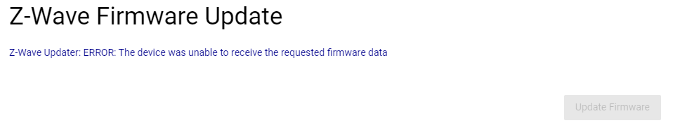

Why does this happen?
I tried it after a reboot, nothing was going on in the logs,
am I ever going to be able to update the firmware?
I waited about 10 minutes after the reboot before applying the Zwave update, went smooth.
Do a shutdown (from the menu). Then power down for 30 seconds. Power up again. Then wait a good 10 minutes and then update.

Will try again, "thebearmay" way....
Patience, patience, patience, and carry on!
Same here, I updated the main firmware, rebooted and then waited at least 10 mins before running the z-wave firmware update. The latter took about 10 mins by itself.

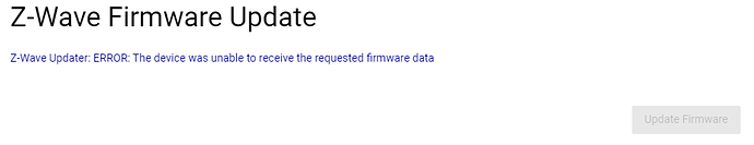

Try #5:
Unfortunately, the "bearmay" way has not delivered the goods for me this time.
ARGH!
try again, patience and carry on!
@jtmpush18 what's been working for a lot of people is to add two steps to your list:
According to @bcopeland just displaying the z-wave details page involves a lot of internal calls to the z-wave stack that can clutter up the works. The additional wait allows the queue to clear. With a few exceptions, this trick has worked for most people.
This seems to me one of the most important parts of a successful update for those who are having problems.
