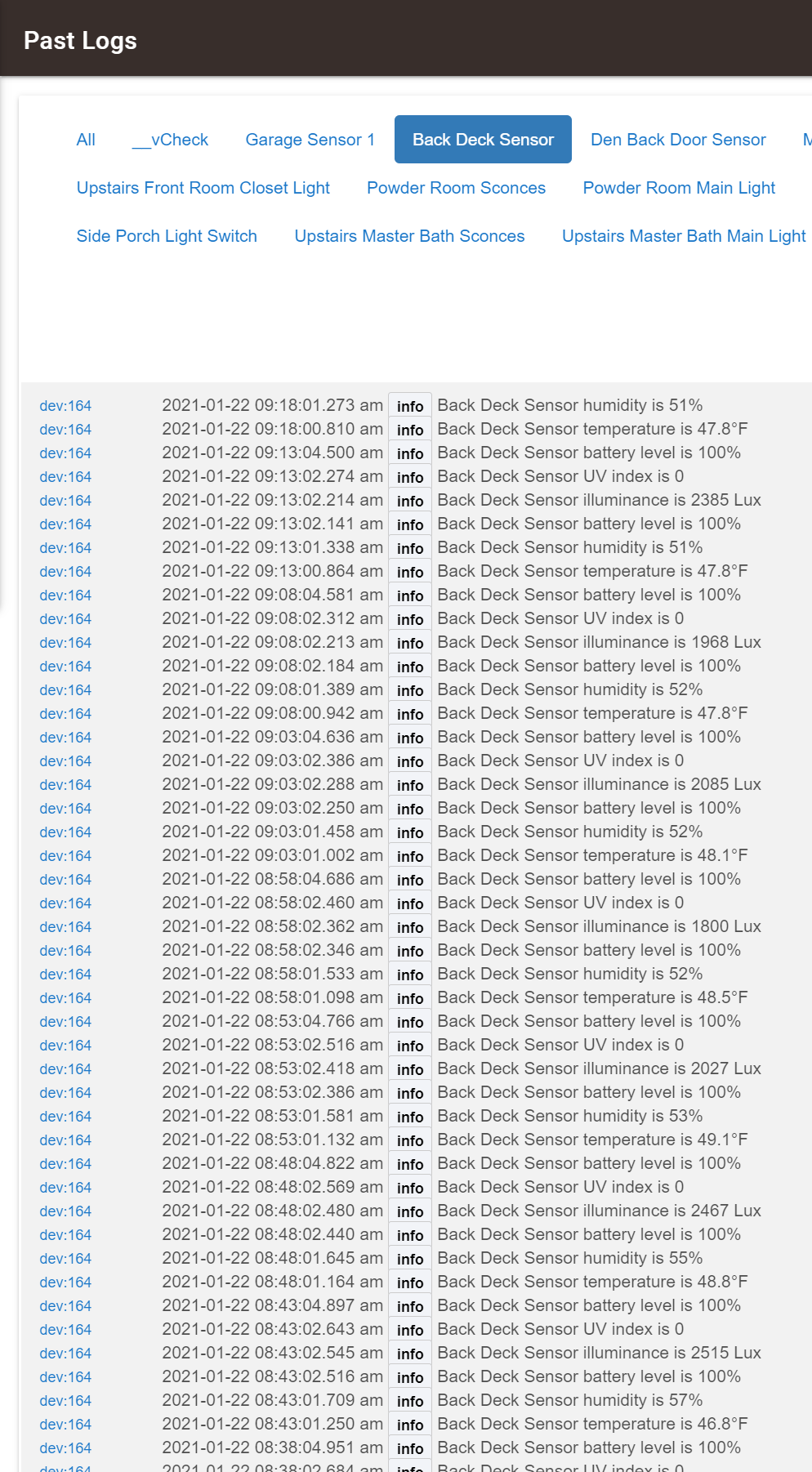

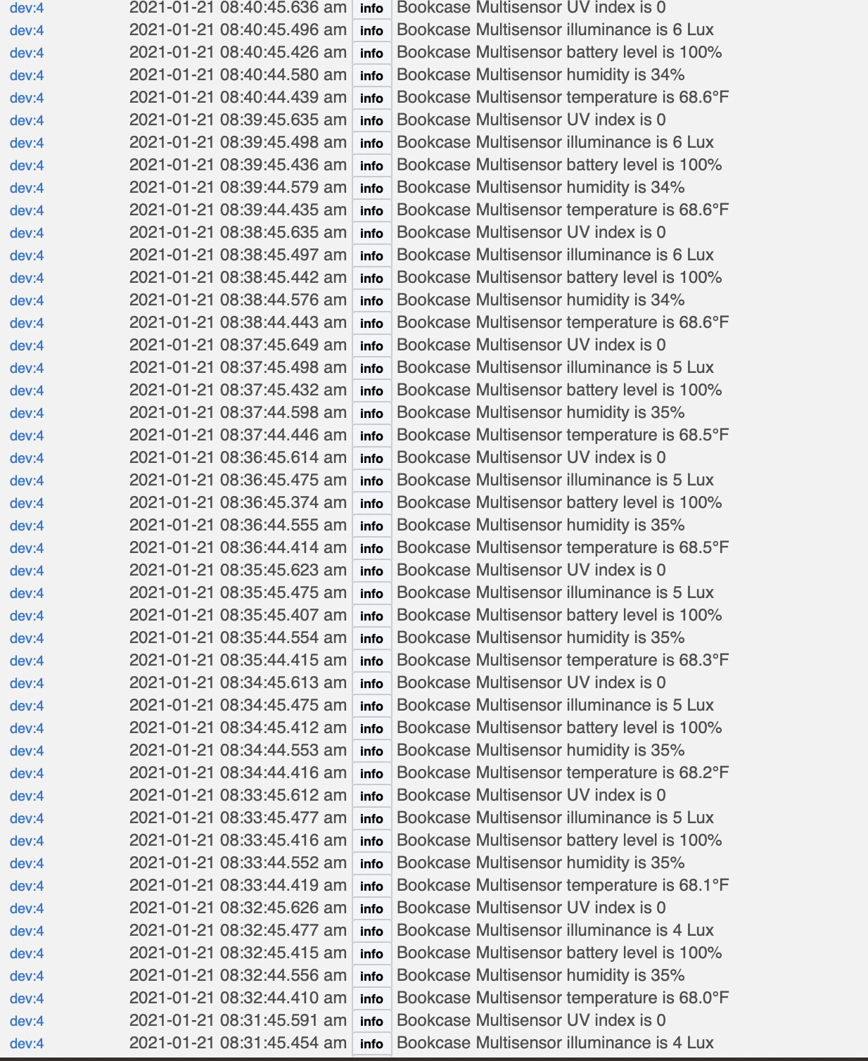

I had switched to the HE for Aeotec MS6 driver recently (was still on 2.2.2.129 on C-5). It was working fine and then I upgraded to 2.2.4.158 a couple of days ago. Yesterday I noticed that I was getting reports every minute (battery, illuminance, humidity etc.).
I went ahead and looked at mine on my C-7 fw .158.. my back deck sensor is on the system driver and seems okay. I originally had csteele's and switched back but cannot remember if I hit "configure" or not.
Mine is USB powered as well - quiet now once I switched drivers.
I had the same and I too cannot remember if I hit configure or not. What I'm sure about is that the report every minute started after updating to 2.2.4.158 (there are no battery entries in my database before that), so maybe the update reset something? Anyway, it's all good now with the new driver...
