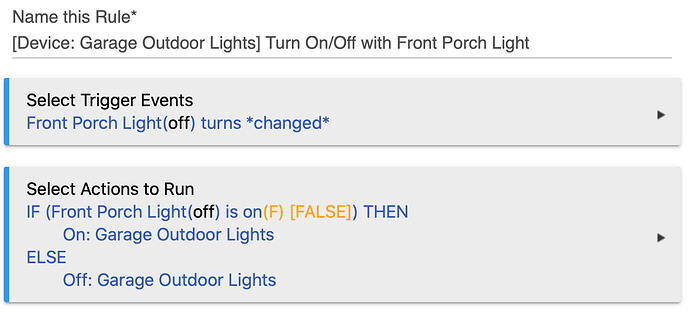

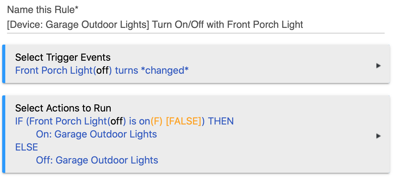

Here is my rule to keep two light switches in sync. This is about as efficient as I could get it. Initially I had it as two separate rules (when Porch Light turns on then turn on Garage Lights, and visa versa), but when it wasn't working I thought maybe I could lighten the load on the hub. Before that was the Switch Bindings app, and I just figured it was buggy. For the record, I no longer think that.
I mean, that should work. I still have not seen a time when Hubitat did not correctly process the physical "on" action, and there hasn't been a time when it couldn't turn on/off the Garage Outdoor Lights. Everything that leads up to this rule works as expected without problems - this is NOT a Z-Wave network issue.

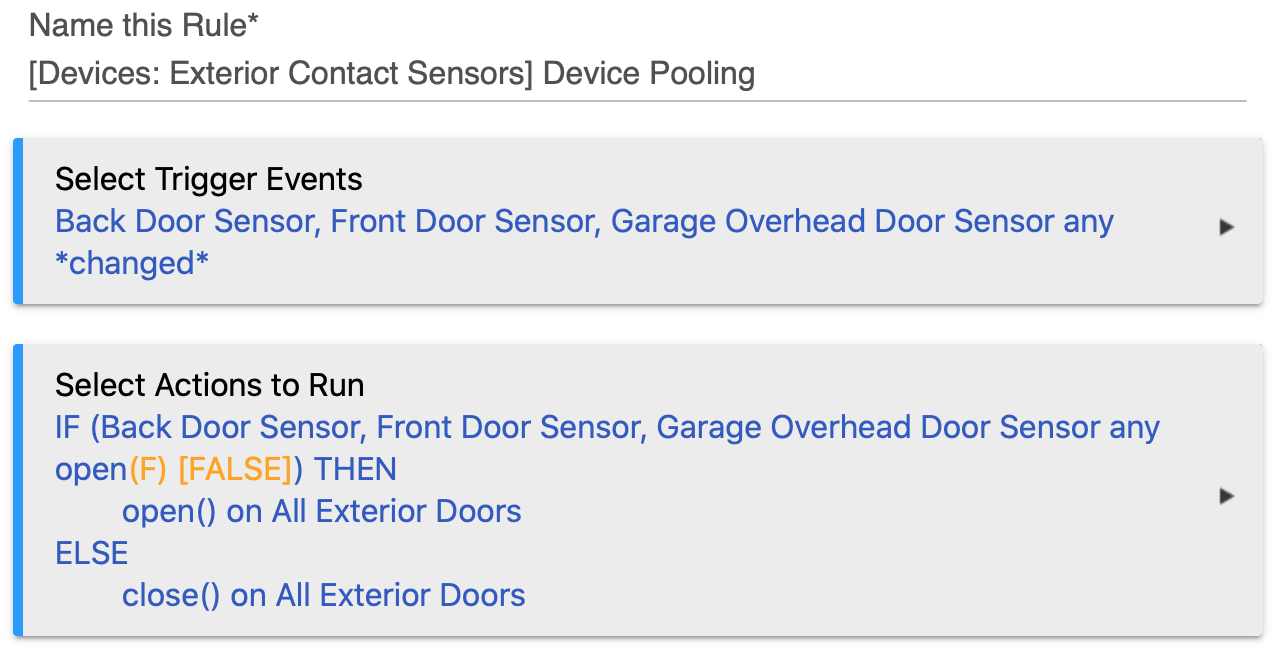

Here's the rule that tries to pool Zigbee contact sensors.
Still pretty simple. These contact sensors work great. I don't know what else to say, aside from there are only two other rules in Rule Machine (one of which triggers based on the virtual sensor shown here).

The ocd in me wants an endif to close it out but that's just me. The hub assumes an endif if it's missing. The logic in the rule is fine as it is. Are all your real sensors Zigbee or zwave? What brand? If zwave are they all plus? What build of hub firmware are you running 2.2.4.134?
I mean, I can add an EndIf, that's no problem.
The sensors are from Aqara, and they work great. I have another that doesn't work quite as reliably ("Garage Interior Door"), but that's not an issue for this particular rule.

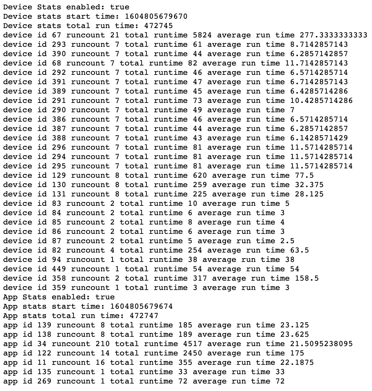

Ok, here's what it spit out.
Device ID 67 is my Hue hub, and app ID 122 is Sonos Integration - those are my two biggest offenders, from what I can tell. And I'm not even using Sonos right now...
I've definitely noticed that a reboot will solve the problem temporarily.
Those all look acceptable and the average hub load appears very low.

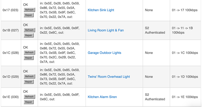

This hints to a possible que issue. Can you post a screenshot of settings, zwave details? Include all the devices.

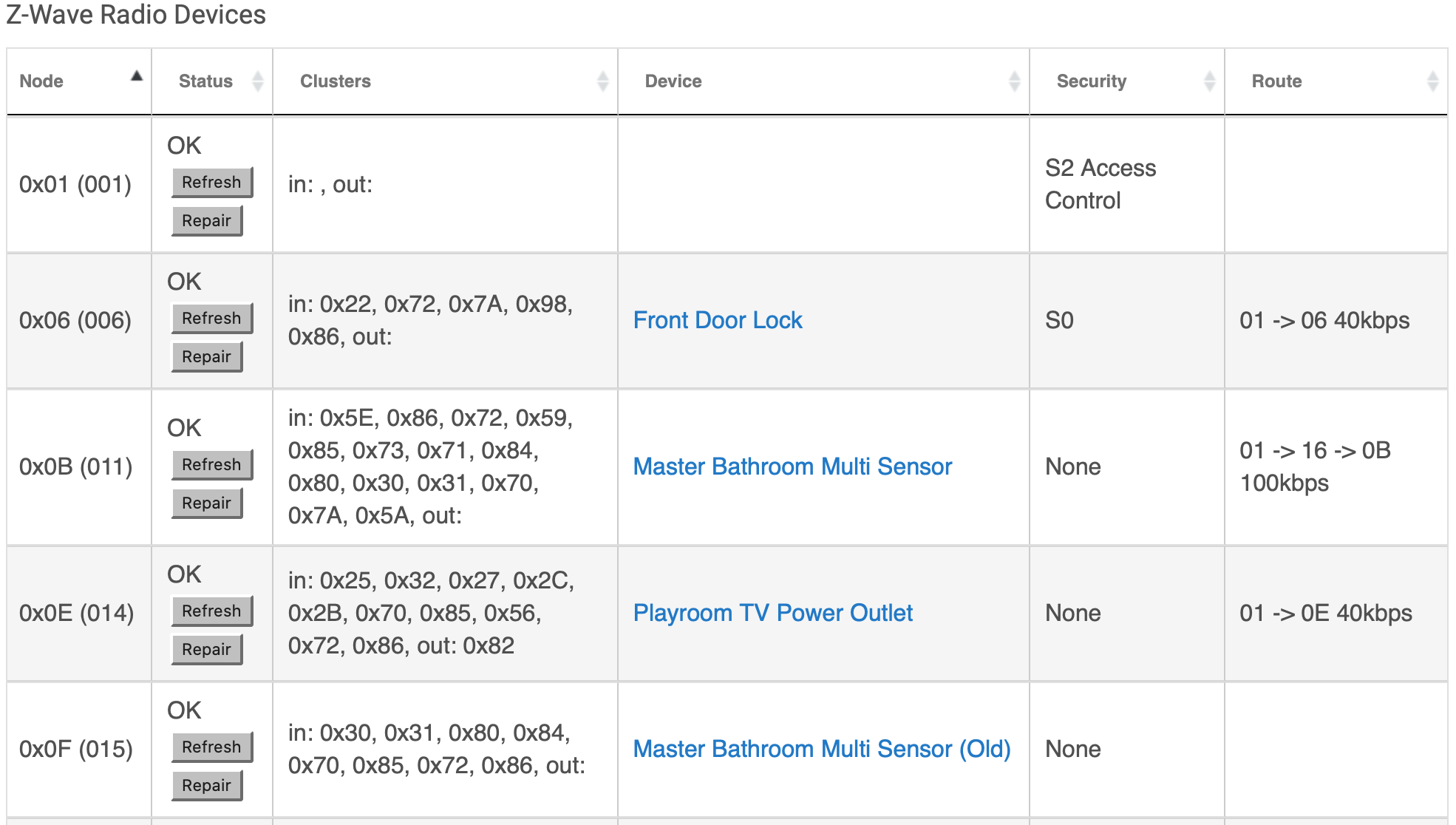

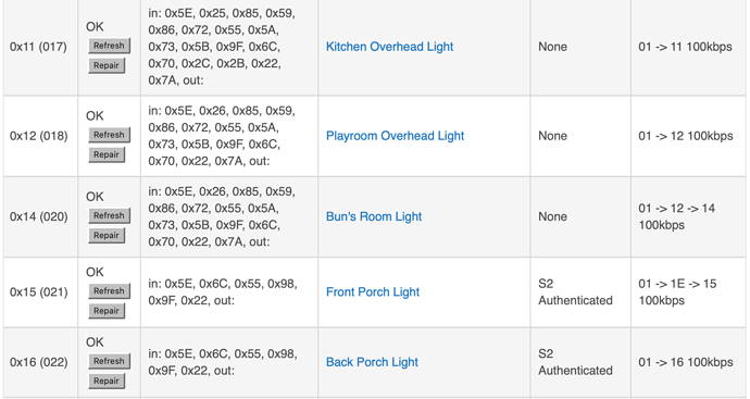

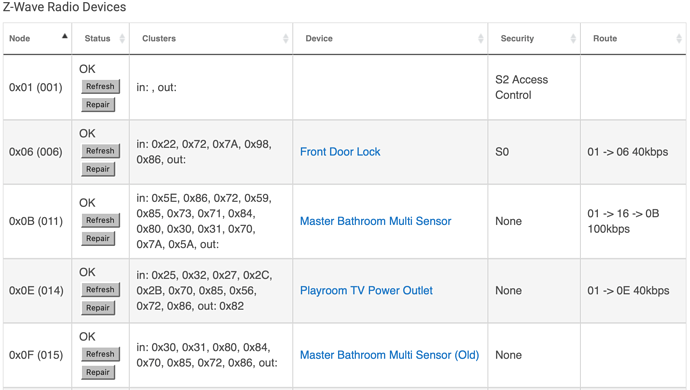

Here you go.
The "Master Bathroom Multi Sensor (Old)" has almost-dead batteries and doesn't work that well anyway. I need to remove it, but I haven't gotten around to it.

is your siren hardwired.. kid of strange to see it being used as a repeater.
Yeah, it's an Aeotec Siren 6.
The S2 devices what make and model are they? Know the firmware build?
Guessing this is an old non-plus zwave repeater. Nothing is using it. Any issues with removing it?
The S2 devices are Inovelli switches and a Light/Fan controller. I do not know their firmware version.
The repeater is there to make sure the "Garage Outdoor Lights" (the switch on the slave end of this broken sync relationship) can always talk. I've had network issues with that particular switch in the past, and since I installed that they've gone away. I acknowledge that nothing is using it now, but I don't know if I want to remove it or not.
That's fine. If it is indeed a non plus device just keep in mind they don't operate as fast as the newer plus versions so the end devices may be capped.
That's fair, I have thought about upgrading it, but it works. :man_shrugging:t2:
