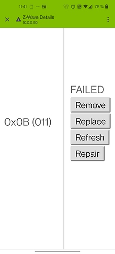

But I do believe, and have experienced, that a weak mesh that may have worked in SmartThings won’t work with Hubitat. Possibly it’s because the antennas are weaker on Hubitat than on Wink and SmartThings. I don’t care, I just want my home automation system to work. If that means that I have to build a stronger mesh, so be it. My solution was to buy 4 Ring Extender 2 devices for my C-7, and sprinkle them around. That has made my C-7 solid, except I occasionally get “Failed” or Not Responding” messages for a couple of Aeotec Recessed Door Sensor 7 devices, even though they work fine. I just ignore the messages because they don’t affect operation.

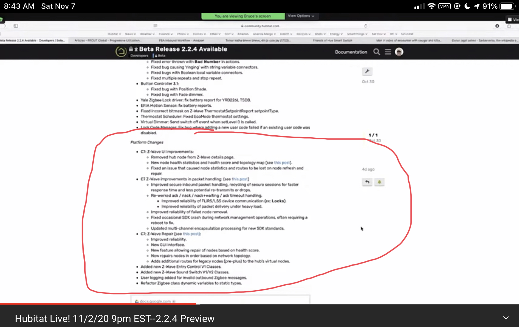

I agree with Jason Bottjen (@JasonJoel). Here is the relevant screenshot from this week’s Hubitat Live video on the 2.2.4 firmware update:
The hub doesn't have any repeater functionality, no. But what does? The first one who gets the right answer gets two points :blush:
The hub is a primary zwave controller. Are you asking if it will repeat if it is joined to a zwave network as a secondary controller?
All mains powered devices repeat. @672southmain suggestions are sound though mesh weakness is one of the two main reasons for issues right now. Second being messed up joins. Either failed pairs or s2 join fails because of device firmware due to bugs in the silabs 700 firmware as well as the device manufacturers. Ghost nodes can be found in settings zwave details. Just look for devices with nothing in the clusters field besides the first which is the hub radio.
