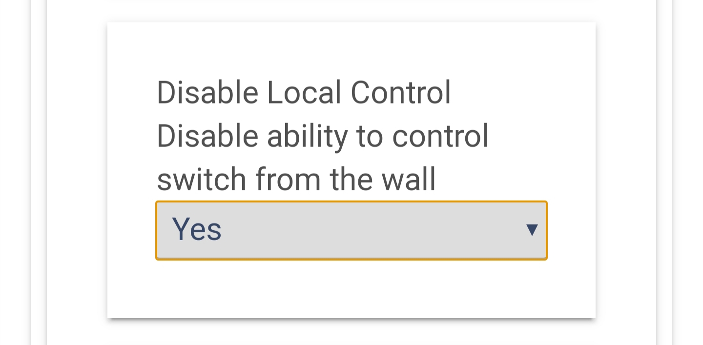

All of the outdoor floodlights were wired to a single switch just inside the front door of our 80's house.
I replaced the individual lights with Singled motion-sensing floods. I need for them to be powered all the time and people instinctively want to flip the switch at the door.
I deactivated local control at the paddles in the device part of HE7. Works perfectly.
Someone more knowledgeable about Inovelli dimmers may know how to invoke "certain time".
You have to enable the option in a custom driver like Inovelli's that creates a child device for (or exposes a custom command for) enabling/disabling local control, which is an option their driver provides. Then you can use that device in an app/rule that fires at specific times as you would with any device.
