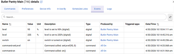

Dimmer set to 255%?!?! ZEN77 Advanced Driver

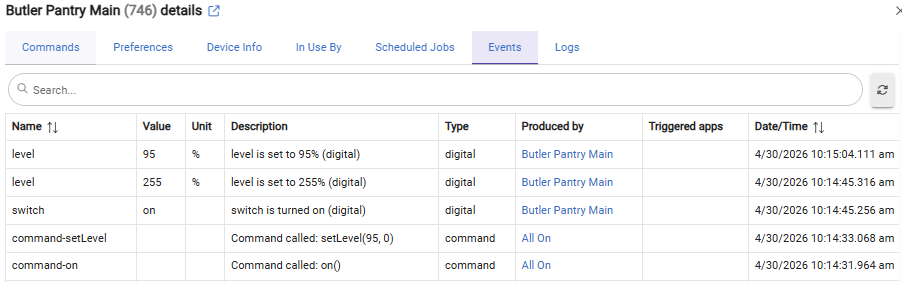

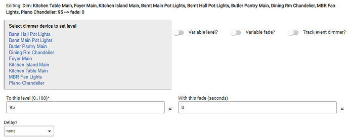

I have a rule that turns on all the lights in the house. It is rarely used (more of a safety feature) but I use it to test ZWave performance.

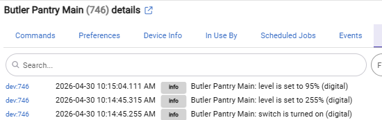

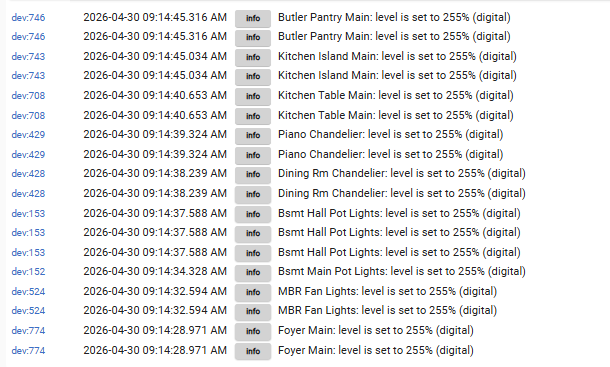

I just noticed today the logs show the device being set to 255% of brightness. That seems an odd level..... The rule commanding the setting is set for 95%.
255 seems suspiciously like hex FF so I wonder if there is a bug related to hex2dec or vice vesa?
Not sure this is harming anything other than an erroneous log entry. Is this a device reporting, driver logic, or system bug?

Ah.. If it's ZWave-JS .. I think I know the problem.. Can you confirm @CuriousB
yes ZWJS
Ok.. I'll get that fixed..
Fixed in the next build
Thanks, cause yeah, this is not my problem. The device would never be responding with that value, it is not a valid response. The driver just accepts whatever the device responds with (unless using brightness correction) and pushes the event.
My driver will SEND the 0xFF value to the device for an "on" command, which tells the device to turn on to its default/last level. In this case though @CuriousB said they are being explicitly set to 95, so the 0xFF would not be used. So I have no idea where ZWJS would be hallucinating this 0xFF from.

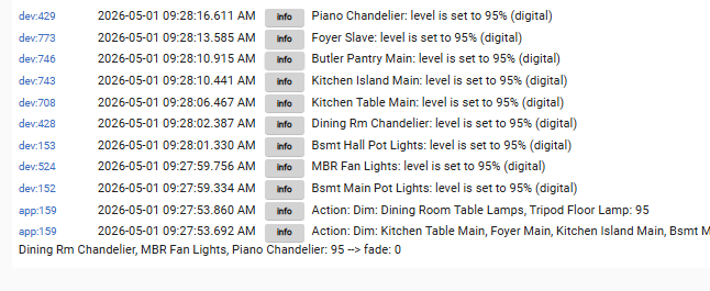

Confirmed fixed in 2.5.0.129
Nice.. Thanks
