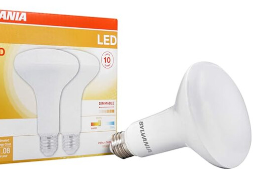

I have Sylvania BR30 in my kitchen and they get adjusted to different levels automatically every day, have not noticed any flickering. Have had pretty good luck with all different Sylvania bulbs on the Zooz dimmers actually.

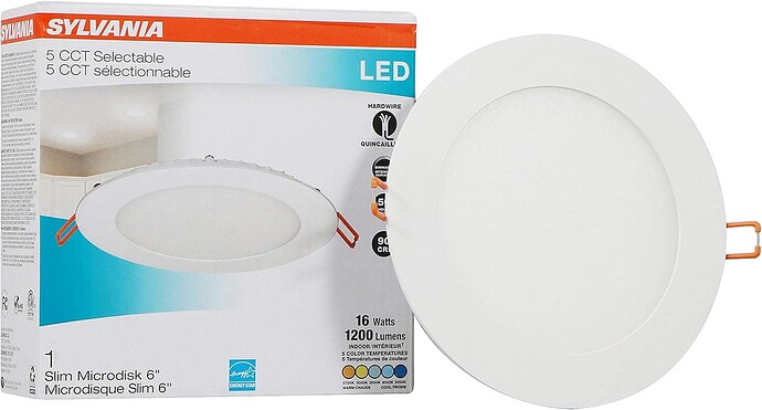

Do you have any of these by any chance? This is kind of what I'm talking about. I should add a picture on the post:
No I have actual BR30 bubs in an old can light fixture, probably they are something like this
The ones you linked to are more for a new build, not a retrofit. If you have an existing can light housing they do make "wafer" lights like that for retrofit as well, they would come with an adaptor you screw into the bulb socket and way to attach it to a standard can housing.
I would only go to the wafer lights if there is some extra feature it has which you want vs just a BR30 LED Bulb.
That is common with low quality bulbs (flicker at lower levels), or sometimes just bulbs that don't play nice with certain types of dimmers.
Oh now that you added pic I think I understand better- I assume you already have that style (not the traditional kind) ... in that case sorry I don't have any great recommendation. I'm using a bunch of Sunco ones like that too that were retro installed where no fixures were previously. They dim OK to about 30-40% but do seem to flicker a bit on trying to go any lower (not terrible ~ but I cant stand any flicker).
These are the exact ones I have so they’re retrofit for cans.

But, this may be a blessing in disguise as I can probably just get those Sylvania BR30s. This may be a dumb question, but is there a way to make these look like wafer lights?
