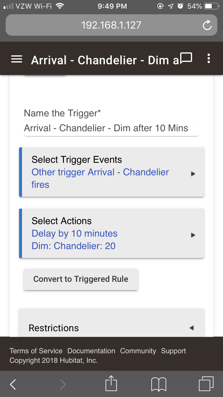

I’ve got two triggers.
  1. I arrive, dim light to 75
  2. condition: above trigger, action: delay 10 mins and dim to 10
Today my eyes were beat when I got in, so I turned the light off. Ten mins later it came back on, which i guess makes sense with the current setup.
What’s the best approach for preventing that from happening? I’m thinking my 2nd trigger maybe needs to become a rule?
I'm confused on the above trigger being a rule part. Post screenshots of what you have set up.
I'd add a 3rd trigger that says if the light turns off, stop actions of the 2nd trigger. I don't see how you can make the 2nd one a rule since the device you want to run the rule is different than the device you want to have cancel the delayed dim.

The issue is that when someone arrives home, trigger 2 schedules a dim action for 10 minutes in the future. If he turns the chandelier off during the 10 minute window between arrival and dim, the scheduled dim action turns the chandelier back on.
What needs to happen is that the scheduled dim action needs to be canceled if the chandelier turns off.

Thanks for the ideas @destructure00 and @homeauto2112, going with the 3rd trigger to stop action for now.
